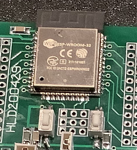

ESP32 Board having this laser engraving: ESP32-WROOM-32 on the metal cover/RF Shield strats uploading without any user intervention.
My previous board with this laser engraving on the metal cover/RF Shield:
ESP-WROOM-32 required user intervention (hold BOOT Button and then release when uploading starts).

Odd, the raw chips I use differently require the process mentioned in my earlier post above.

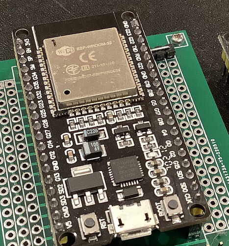

And the Dev kit:

When my previous 30-pin ESP32 Dev Module (ESP-WROOM-32) broke out, I ordered three 30-pin ESP32 Dev Module (ESP32-WROOM-32), which uploads sketch just like UNO without searching for connection that was not case for ESP-WROOM-32.
