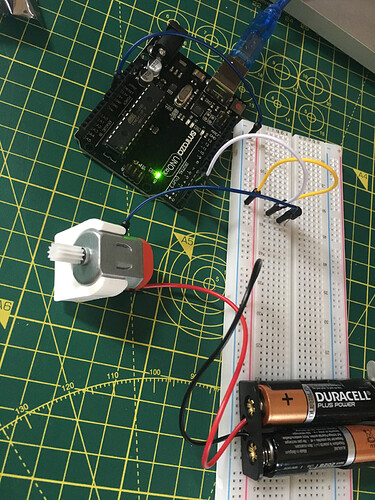

I'm a complete newbie (got my first Arduino two days ago) but loving the lessons so far. My interest in Arduino comes from wanting to try a few things with analogue photography equipment.
Anyway, I've been trying to use a hobby motor with the Arduino so I can use Pulse Width Modulation to control and test the speeds. I've been following this video for advice: Arduino Motor Interfacing using MOSFET and PWM - YouTube
I'm using a 2N7000 N-channel MOSFET, so I think the same one as in the video.
I'm not sure of the specs of the hobby motor, but here is the Amazon listing: https://smile.amazon.co.uk/dp/B07KPTC429/ref=cm_sw_r_tw_dp_U_x_eJPaDbE2JGFQN
When I plugged it all in and uploaded very simple code, nothing happened other than the MOSFET heating up (I quickly switched off).
There's nothing wrong with the circuit (I tried inverting the MOSFET connections which completes circuit and runs the motor - even without the sketch running, maybe not a good idea).
Any idea what the issue is? The motor? Something else? Any work-arounds?
FYI - My ideal motor speed is in the vicinity of 72rpm, although I can go a little lower and 2 or 3 times higher potentially with my DIY gearbox (not pictured).
Code below and images attached.
Thanks in advance for any help!
Mike
  Motor with MOSFET

The circuit in the video has a couple of problems. The big one is that there is no flyback diode to shunt the reverse voltage created when the motor shuts off. That voltage is easily high enough to kill a MOSFET. There should (arguably) be a resistor between the Arduino output and the gate to limit gate current while charging the gate capacitance. The 10K pull down resistor will prevent the motor from starting while the motor control pin is floating, before it is changed to output in setup(). The cap will help to filter out motor noise. The resistors and cap are optional, the diode is not. The 2N7000 may already be dead from the reverse voltage spike. Try a new one after adding the diode and carefully checking the circuit.
The 2N7000 is good for 200mA. Is the motor stall (starting) current less than 200mA?

First off, I have 2x Diode Rectifier (1N4007) that came with my Arduino kit - are these flyback diodes / will these work?
I'm not sure about the mA but it could but similar/same model is rated as: 1500 mA at maximum efficiency, 400 mA at no load - does this mean its too high for the 2N7000. If so, what are other options available (of any sort)?
Cheers
A 1N4007 diode is fine for a flyback. A 2N7000 is way under rated for a motor that draws 1500mA at startup. It likely will not survive. I don't know a proper MOSFET off the top of my head and don't have time to search. Look for a logic level MOSFET with 2A continuous current.

Best to add the other parts (at least the two resistors and the diode) shown in the reply #1 schematic.
