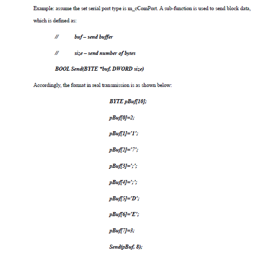

Hello! I've been trying to communicate with an NIBP module (UN600F) through UART using an ESP32 and I need some help. I tried making the module take a manual measurement once but then it doesn't start measuring even when I send the proper commands. I'm not sure if the module is faulty or if there's something wrong with my code. I've attached my code below as well as the communication protocol of the UN600F module. Any insight about my code would be greatly appreciated. Thanks!

  Serial2.write(command, sizeof(command));
It's not clear from the doc fragment, but I suspect that the command code and check sum are both supposed to be single bytes.
Does that mean that I have to send the command code and check sum as single bytes? How exactly can I do this in code? I've also attached a command example found in the UN600F's manual. I also tried sending the command code in a single array similar to the example but it still doesnt work.
byte command[10] = {2,'0','1',';',';','D','7',3};

You're still sending '0' and '1' as individual bytes, two of them. You need one.
Try:
byte command[10] = {2,1,';',';',0xD7,3};
