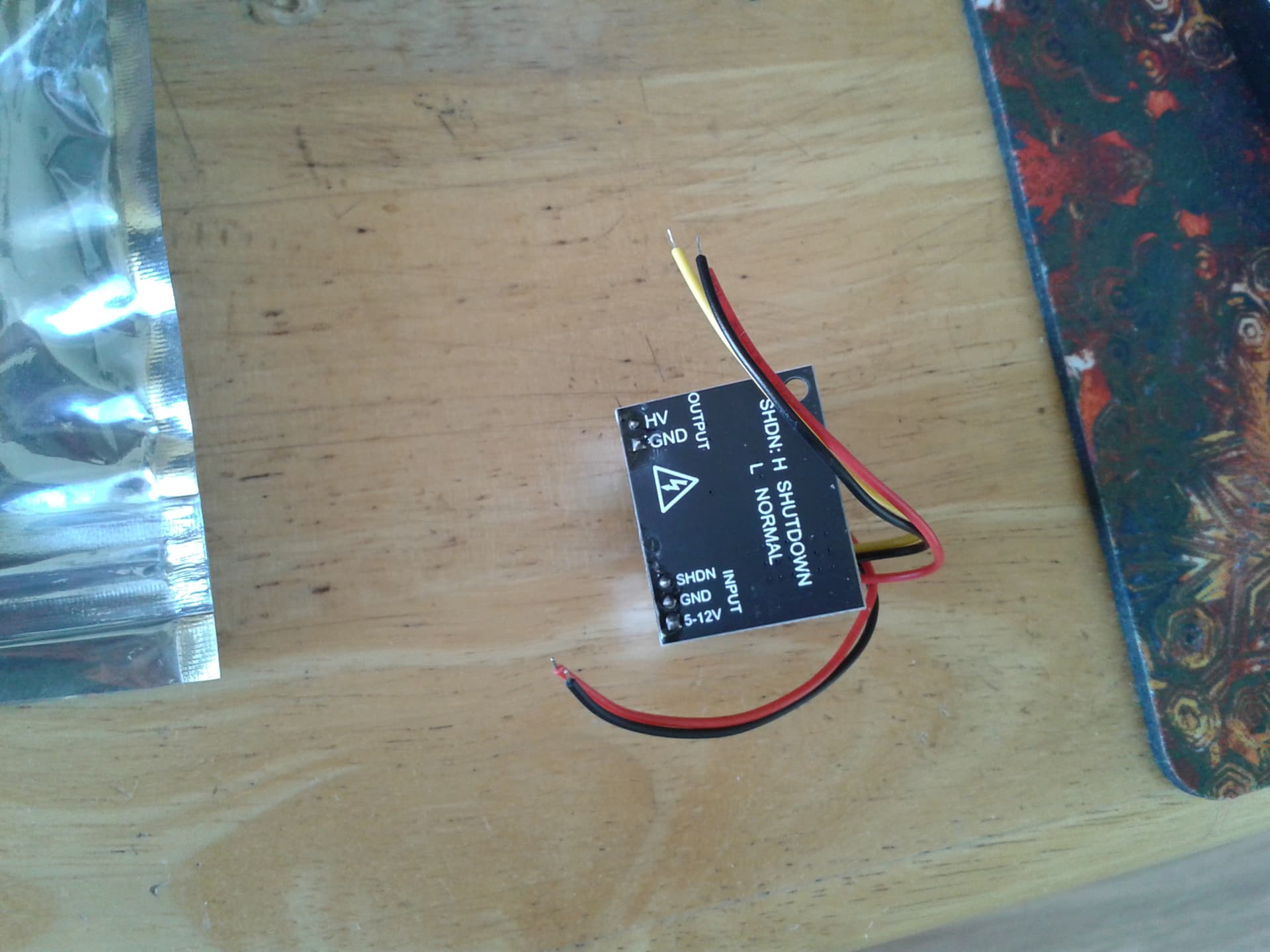

I retreived several Nixie tubes IN-14, and wanted to use them as a counter. I started with very basic installation on a bread board, and I wanted to control the display with a K155id-1 decoder. But my problem is : the tube seems to have an inverted polarity ! According to the data sheet, you normally connect 170V to pin 1 (anode), and ground to the pin corresponding to the selected digit. When I do it this way, the tube is light up completely, no figure on display, but when I invert the polarity, it works normally and I can get the right digits.
The problem is I cannot drive 170V throught a K155id-1... I'm certainly doing something wrong, but I really don't understand. All schematics I could find specify it should work with 170V on pin 1... my tube doesn't work like this.

Yes, I saw the variable resistor but could not of course see how it was set. The data for the tube is here including how to determine the common Anode and the cathodes for the digits/decimal points: IN-14 (Gazotron) Nixie Röhre - Nixie Tube . A manufacturing defect whereby the polarity of the device is somehow inverted would be extremely unlikely and more plausible would be a user error in interpreting the pinout (the illustration in the linked document is the view from the underside).

Maybe I didn't make myself clear. I see a red and a black wire coming from what I assume is the power supply. What I meant was, how can you be sure that the red wire is in fact positive and the black wire negative ? Did you test this with a multimeter? A picture of the power supply also might help. Is it possible that the outputs are marked 0 and -170v.

Can you supply a link to the vendor page of that Nixie power supply if it is not similar to this one. High Voltage DC Step Up Converter Power Supply Module For Nixie Tube Board | eBay

Here is the power supply I'm using : 512V to 150220V Boost Converter Module MAX1771 Drive SZ31 QS301 Voltage | Fruugo UK
I chose that one because it takes 5V - 12V as input and I wanted to use an USB power supply in the final version.
But I will try the one you mentioned, I think you're right blaming the power supply...

Ok, I think I found the problem, big thank to all of you for your support !
It was so stupid... The power supply was effectively guilty, but it was simply the wires which were wrong : red was ground and black was +170V !!!
I checked again with the multimeter (I did it already, but I probably did it wrong or didn't notice the "-" sign on the multimeter !), and it's quite obvious...
So problem solved, sorry for bothering you with such a stupid problem, and thanks a lot for your support !

OK. Good. So we can conclude that the red and black colour coding of the wires was somewhat misleading. Thanks for reporting back.
on that kind of connector is not standard. Well let's say I have many of those and they present themselves in both possible standards.

I bought 2 units to make sure i have 1 spare, but my wire colors are the right way around
No only that, there are markings on the silk on the back
I would be surprised if yours doesn't.

Yeah yeah but for any future issues, check the back of the unit.
