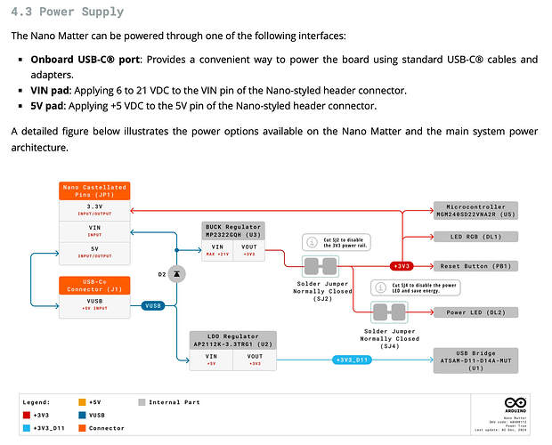

When I power my Nano Matter from USB, my multimeter shows the 5V pin (IN5V) having 0V. The VUSB pad on the back of the board (unlabeled, next to the IN5V pin) reads 5V. The 3.3V pin reads 3.3V.
The full pinout document says the 5V pin "Outputs +5V when the board is USB powered", so the pin should be giving out approximately 5V.
I haven't soldered or cut any of the jumpers. I don't think I need to for setting 5V out, but I'm not sure what I am missing at this point.
If anyone has any ideas why the 5V pin isn't outputting 5V, I would greatly appreciate your help.
I think the name IN5V is a clue. Looking at the datasheet power plan I do NOT see any 5V OUT pins, only 5V in. Sorry for the poor quality.
@sonofcy Your diagram makes more sense given the readings I'm getting.
The diagram I was looking at is from https://docs.arduino.cc/resources/datasheets/ABX00112-datasheet.pdf which I found linked on this page: https://docs.arduino.cc/tutorials/nano-matter/user-manual/#datasheet

On my Nano Matter, pin 12 (IN5V) reads 0V when the board is powered by USB. If pin 12 were VUSB, I think it would read 5V. There is a pad on the back that is next to pin 12 that I think is VUSB. The pad reads 5V when the board is powered by USB.

I spoke with Arduino support. There are two versions of the Nano Matter board.
  1. Community Preview Nano Matter is no longer being made, but some stores still have inventory (e.g. Mouser)
  2. Nano Matter (final version) is available at the Official Arduino Store
The Community Preview Nano Matter does not have 5V out, as indicated by the IN5V pin.
The final version Nano Matter has 5V out, as indicated by the 5V pin.
I now own both a Community Preview Nano Matter and a final version Nano Matter, and have confirmed the difference between the two boards with a multimeter.
In short, if you order a Nano Matter and it arrives with an IN5V pin, it is the old Community Preview version and does not support 5V out.
