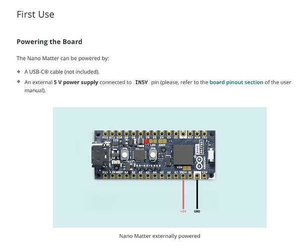

So, I tried connecting a 5v supply to IN5V and it just doesn't work.
I bridged the jumper from VIN, also doesn't work...
Followed the pinout instructions, tested on two boards, no success.
Voltage is very stable right at 5.02v.
Powering from USB-C works fine!
Am I missing something???
I would appreciate any help on this basic issue!
source: https://docs.arduino.cc/tutorials/nano-matter/user-manual/#pinout

the doc seems to indicate you need to solder the pads only if you power from Vin

Electrically, when the VIN-Jumper is bridged, it connects „VIN“ and „IN5V“ together.

I suppose that if you power it from the 3V3 pin it works, as it works from the USB.
It's strange. Looking at the datasheet:
from the symptoms the only thing I could imagine is that the Q3 mosfet is damaged. But it's strange that it's damaged in both boards.
Q3 here works like a diode, more or less.
If you can identify in the board the point between Q3 and U3, for example the C3 capacitor top lead, you can check the voltage there with a multimeter, when only IN5V is powered. It should be 5V, and zero and at VBUS.
Check also the voltage at 3V3.
It's a hard voltage switcher with no limiter. :confused:

To be clear, should I measure here? Top Lead of C3 and U3 VIN?
I didn't fully understand what you meant by "and zero and VBUS", could you perhaps briefly point out where I should measure on the schematic?
Yes. If the mosfet is working you should see 5V there.
Find the top lead of C5 (the red arrow in Jim's post #9), or Vin of U3, or the "2" pin of the mosfet... whatever is easier to identify and test.
And if you see 5V there, you should see 3.3V at the output of U3, that is also the 3V3 pin, I think.
If you don't see 5V there, then you have to check the mosfet. Check the 3 leads. Without the USB cable the lead 1, the gate, should be zero. But anyway it should conduct between 3 and 2 (source and drain), so leads 2 and 3 should be 5V.
Sorry, was a typo, should be: "and zero at VBUS" I mean, when you don't have the USB cable connected VBUS should be zero.
