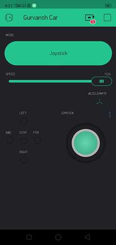

Hello,
I Have Made A Accelerometer And Joystick Controlled Internet-Based NodeMcu Car With Blynk App. I Have Used Accelerometer Of The Phone With Gives The Value Between -9 To 9 On X And Y Axis And Blynk Joystick With Values- -1, 0 And 1 On Each Axis(To Simplify The Code). The Is A Button To Switch Between Accelerometer And Joystick Modes, A Realtime Speed Control Slider And 4 LEDs To Know Which Command I'm Sending Through My Phone Accelerometer(As It Is Very Hard To Configure Between The Coarse Values).
I Have Inversed The Axis In Forwarding And Turning Commands Because I Held The Phone In Landscape Mode During Accelerometer And In Portrait While Using Joystick.
The Components I'm Using Are A NodeMcu, 4DC BO Motors, And A L298N Motor Driver To Drive 4 Motors(Left Motors On One-Socket And Right Motors On Other Socket).
Code Is In The Next Post As Character Limit Exceeded.
This Is My Blynk Setup
I've Used Int Before As I Can't Used Blynk Variable In Code And Made New Void And Timers As I Can't Use 'Blynk' Commands In Loop And Also To Simplify The Code.
Now, I Want To Still Shorten The Code And More Simplify It. Please Give Suggestions.
Also, I Want Suggestions For How Many Amps And Volts Should THe Power Source Have To Power NodeMcu, Motor Driver And Motors.
Kalpit
