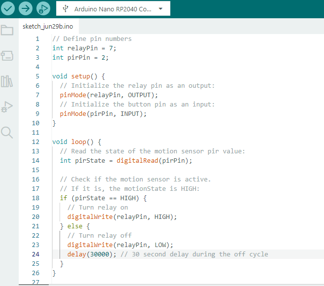

After I got "upload" under control I loaded Blink first, and then loaded my project sketch which is pretty straight forward. Arduino see the signal from a PIR motion sensor and fires a relay module. Initially I ran it without any delay to verify it would fire the relay, which it did, then I added a 30 second delay, which was the original plan to eliminate too many cycles. The relay closure turns on a BLI thunder and Lighting device. At any rate, the relay closure still works but seems to fire randomly instead of when the motion is detected after 30 seconds. I'm guessing there is something wrong in my code.
George
