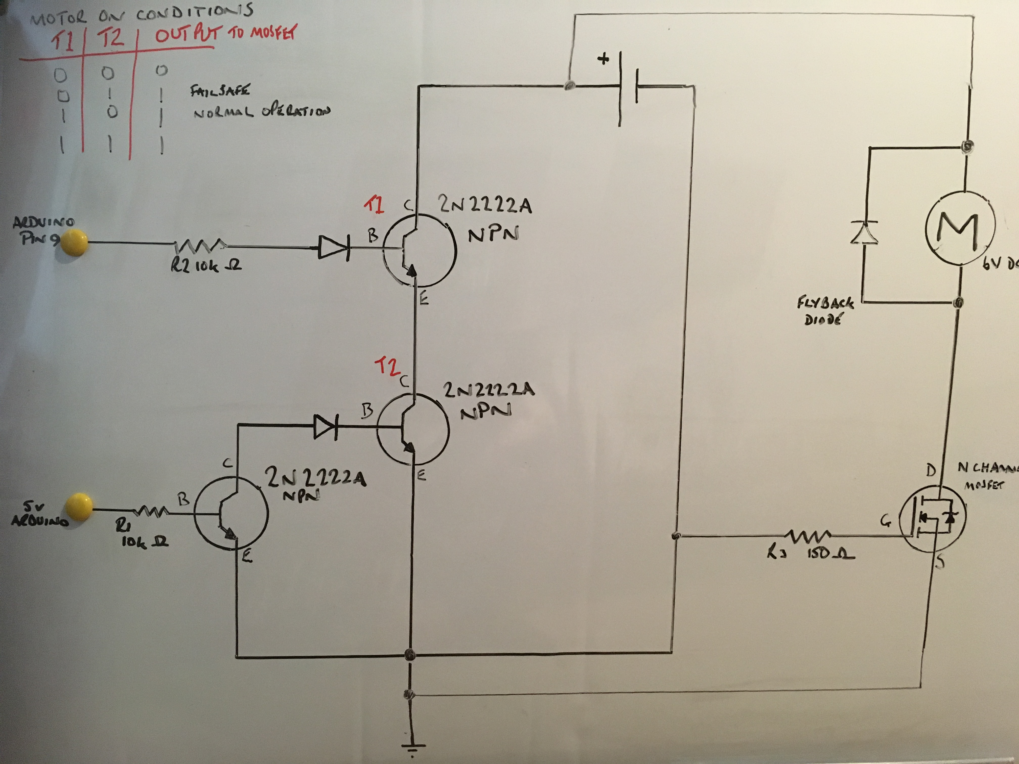

Hi All,
I hope this schematic is clearer and somewhere nearer the mark. If I have understood Mark's comments, the NOT gate forms one of the inputs to a NOR gate, the other input being from the Arduino pin that controls the motor. In the event of the Arduino power failing, the motor will being to work as a failsafe. I've added a flyback diode to the motor although I am not sure that it is oriented correcty.

Hi All,
OK, version 2! :slight_smile:
I've tried to address the isues raise by Mark T
MarkT:
The MOSFET can be driven from the diode logic gate directly, those extra transistors aren't performing any useful
function.
No resistor on the diode driven directly from the Arduino pin, R3 can be 1k or so, and add 150 ohms on the
MOSFET gate to limit the max current. drawn from the Arduino or inverting transistor.
My understanding from initial comments was an OR gate was required, one input from the Arduino pin (normal operation) and the other input from the NOT gate (failsafe - Arduino loses power then zero input inverted to 1). I was confused by the 'extra transistors' suggestion Mark. I've also added the 150 ohm resistor to the gate of the MOSFET.
Tom, I thought about how the motor would be powered and so have rerouted the wires from the motor, hopefully avoiding the short?
I've removed the resistor from the T2 resistor emmitter to ground....I have no idea what I was thinking it would do Mark, thanks for pointing it out!
If I have understood correctly, the resistor R1 10k ohm on the Arduino Pin line should be removed? I have left it in the drawing for the moment. I've also added a truth table to show how I want the MOSFET to be switched on.
wvmarle, thanks for your post, I've adjusted the wiring to the motor as described above and completed the transistor symbols (they are NPN).
I hope this makes a little more sense, thanks for your patience, I'm sure this is straightforward but my knowledge base is very low having only just got into (very) basic electronics for a project.

OP's image:
So... the motor current goes from battery + through two NPNs, then a MOSFET and the motor back to the battery +? That won't work well.
For added fun: when both NPNs are on, they'll start smoking pretty soon.
If you would fix those wiring errors, the n-channel is still on the high side of the motor, and the way you create your virtual GND is just adding to the troubles.
I really don't understand what you're actually trying to do here.
This will work a lot better. There may be options to simplify this circuit, that's a lot of NPNs. Can be done with a 74HC00 (quad NAND) for example.
