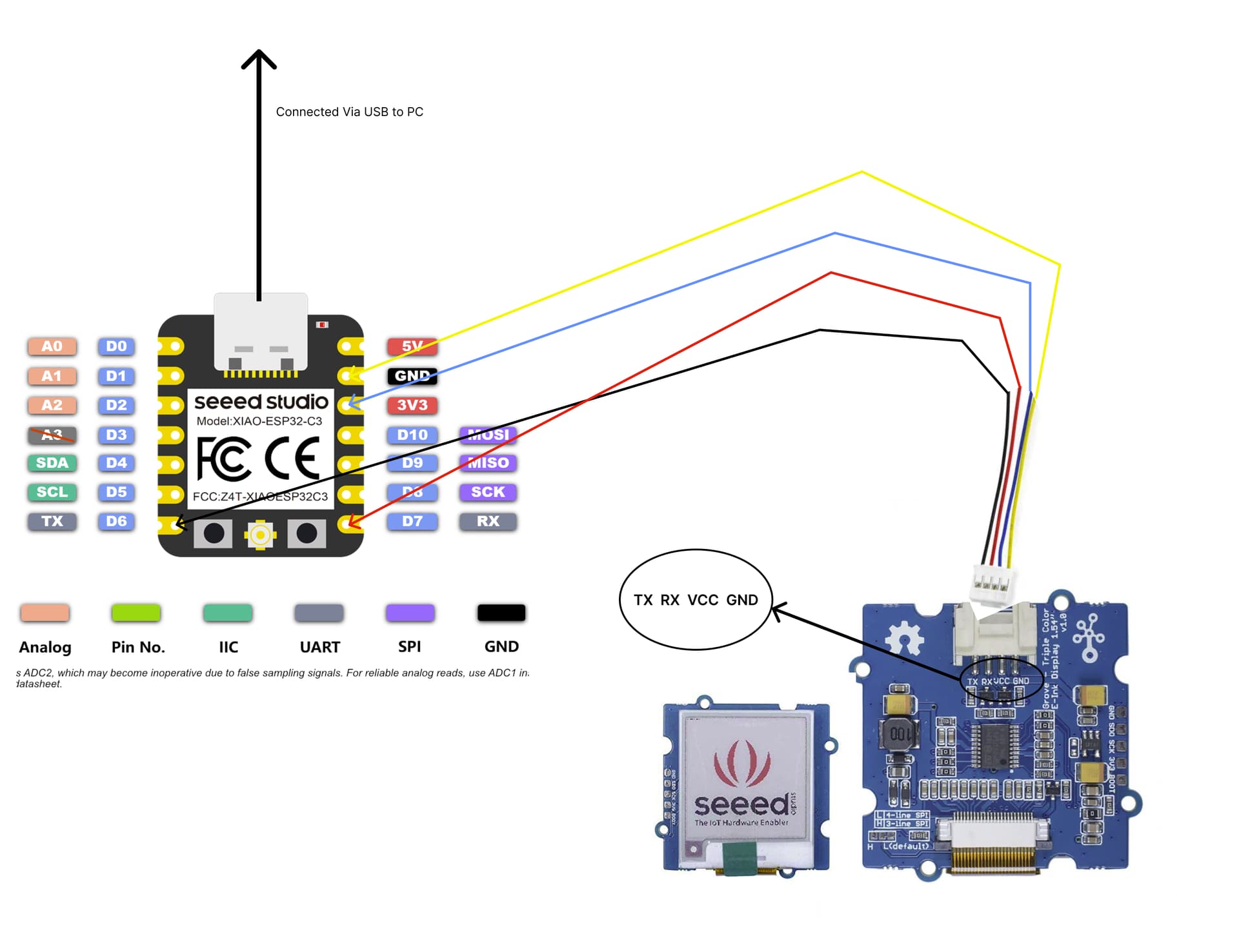

My partner and I are currently working on a uni project where we are using the Seeed Grove triple color e-ink 1.54" display. We tried connecting the display via the UART interface to a XIAO ESP32c3.
We do not want to do anything fancy, other than displaying a bitmap of an image on the screen. For this, we tried to use the demo code from GitHub, linked in the official documentation of the E-Ink Display.
The Problem:
Nothing we tried seems to change the display state, other than the initial screen of the display during the booting sequence. The goal is for the screen to transition to the desired black and red color map after the delay and after each iteration in the loop.
We think our wiring should be correct:
Our sketch looks like this:

I tried adding some more information. Do you think this would suffice, or are we missing something else that could be important? :thinking:
You should have also read NOT to add info to an old post.
Have you tried reversing TX/RX, your diagram seems to have it backwards.
Thank you very much! :grin:
This indeed was our problem for two weeks straight.
Never felt this dumb before... :sweat_smile:
