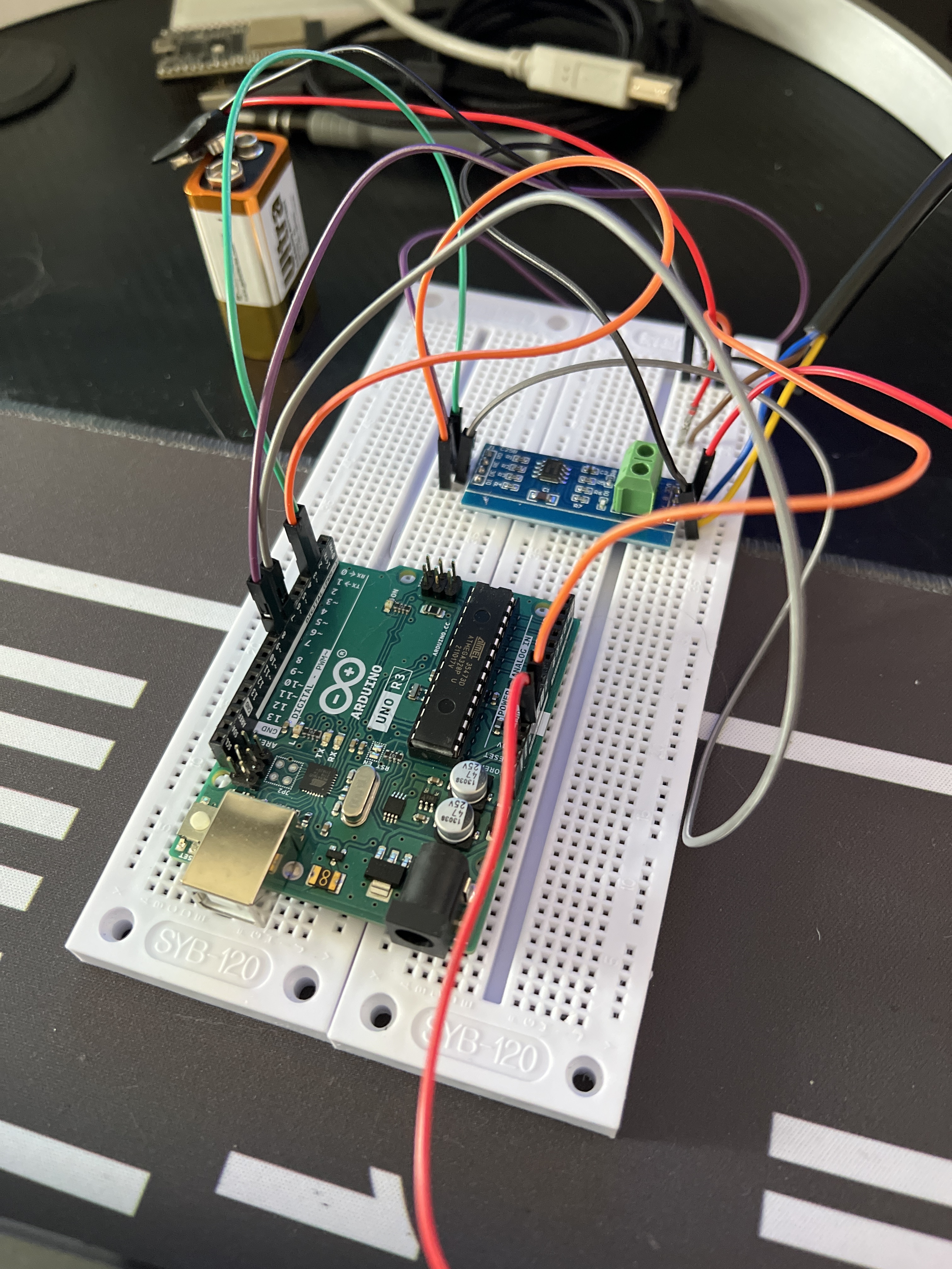

Hello, I'm following this tutorial Tutorial to interface a NPK sensor 7 in 1 with my Arduino, i pretty much sure that my wiring is correct, i follow the schematic in the tutorial and verify many time so i guess some issue on my code.

I simplify the code in order to read only nitrogen, the value i get print out is always 255 .... something is wrong but cant find what.. any suggestion... i don't know where to start look into.
