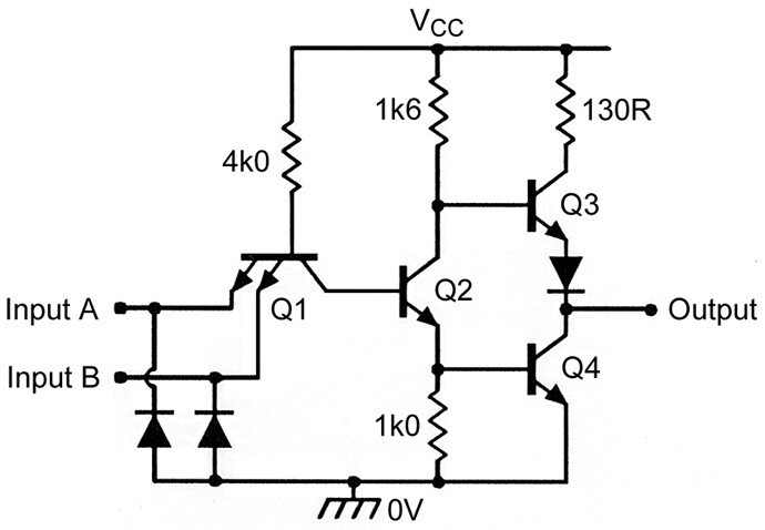

I can see that's an NPN but with two emitters? I've seen that before but didn't know what it was beyond a transistor, sometimes multiple bases and/or collectors too. What is that kind of transistor is that, so I can research it a bit more?

Its something you do on an integrated surface to save space - its two transistors in effect, but its made in the same well. Integrated circuit design allows lots of tricks like this. The emitters can be different sizes, allowing clever effects like bandgap references.
For TTL the multi-emitter device gives AND gate functionality since only if both inputs are HIGH can the multi-emitter transistor turn off.

Actually, in the above diagram, Q1 appears to be just a diode array. The only time it might function as a transistor is to pull accumulated base charge out of Q2 to turn it off faster.

Q1 can pull Base of Q2 to min(A,B). When you replace it by two diodes they will pull to min (A,B) + 0.6 V, decreasing noise margin.
Three diodes, not two.
Re reply #17: I don't see a voltage source for Q1 collector. Should there be a resistor between Vcc and Q1 collector?
