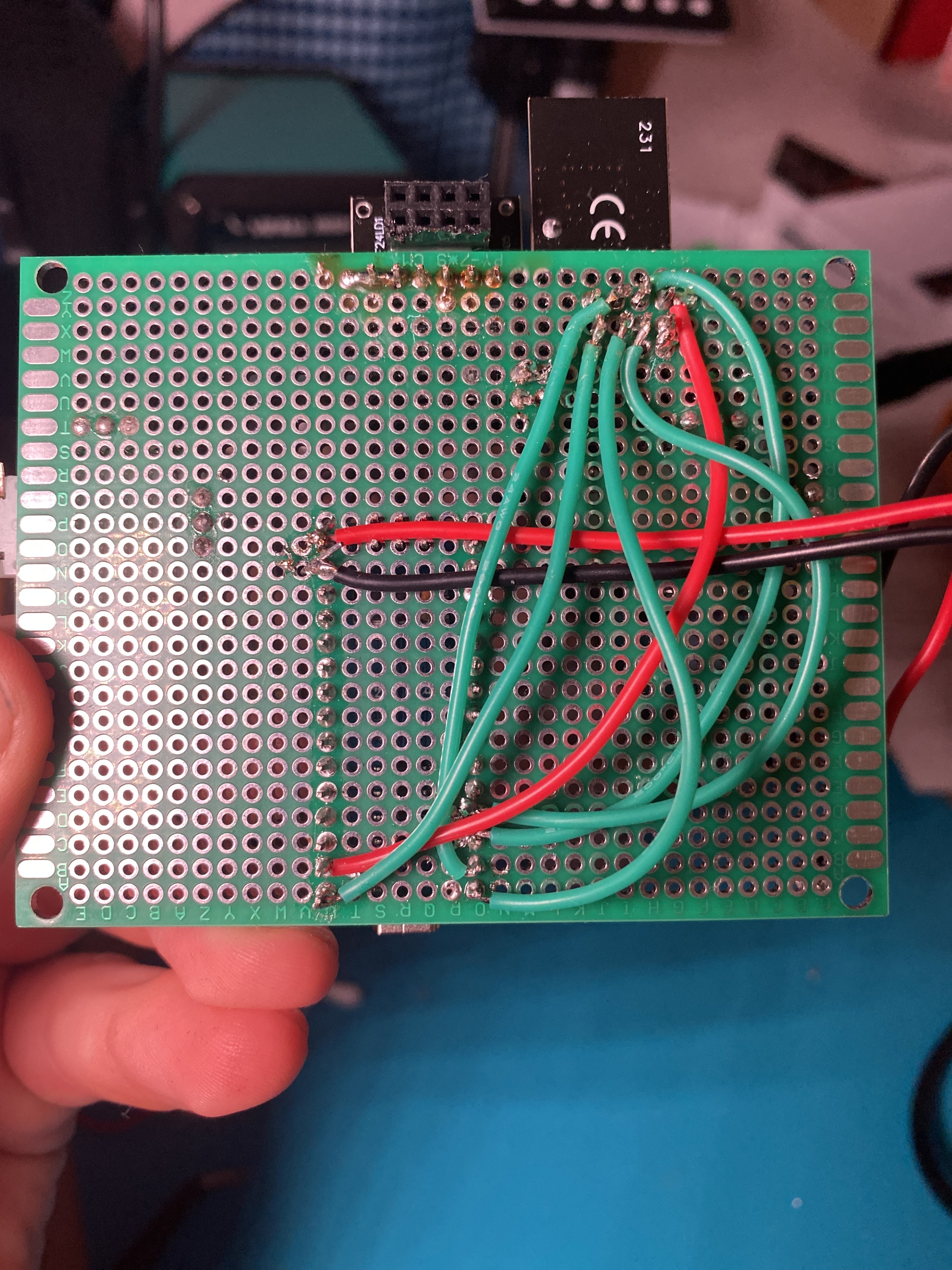

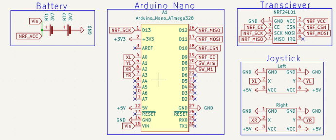

Step1: post an annotated schematic showing exactly how you have wired it. Be sure to note any leads over 10"25cm and how you and all power sources. Also post links to technical information on any other piece of hardware connected to the Arduino.
Step2: We will respond to your schematic.

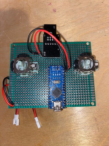

My circuit is based off this schematic, the joysticks are not currently connected. The transciever connections are passed throught an nrf adapter board hence the 7.4V input.
I only had green wires when soldering so appologise for the mono-colour.
using the same SPI connections as your schematic of post ?

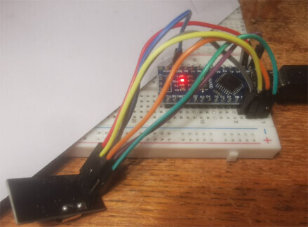

have you an oscilloscope so you can check the MOSI, MISO, etc signals?
I tested your code.
Nano > NRF24L01 Receive text
NF24 is NOT connected to SPI

looking at the second photo in post 2 which shows the soldering some of the connections look very doubtful
have you checked the connections with a multimeter for continuity and short circuits?

I never ended up taking a photo of the setup and do not have it with me currently. I could recreate it tomorrow.
The tests today I used the power from the USB port. Previously I was using 2 3.7V lipo batteries in series connected to the nano's Vin port. This was measured at 7.3V.
I have the Vcc pin on the NRF connected to the 3V3 pin on the nano, and have a 10uF capacitor between Vcc and GND.
this means the basic SPI connection is not working
check the connections
// UNO/Nano connections
// arduino MOSI pin 11 goes to NRF24L10_pin MOSI
// arduino MISO pin 12 goes to NRF24L10_pin MI
// arduino SCK  pin 13 goes to NRF24L10_pin SCK
// NRF24L10 CE to arduino pin 9
// NRF24L10 CSN to arduino pin10
// NRF24L10 VCC to 3.3V and GND to GND

this photo may give you an idea
you can clearly see VCC (red) CSN (yellow) MOSI (orange) MISO (green) and GND (blue) more difficult to see is CE (grey) and CLK (purple)
I know it ain’t a pretty circuit but it’s the best I could do with what I had on hand. I’ve tested each connection with a multimeter.
I double checked my connections and they are the same as you’ve listed.
Note: I do not have a capacitor I can use with me.

difficult to see clearly looking at your photo
have you
MISO connected to pin D13
and SCK connected to pin D12
should be MISO to D12 and SCK to D13?
Yeah you're right I had the MISO and SCK mixed up in my example. I swapped them around, tested the NRF with a 3.7V exteral battery and managed to get hold of a 10uF capacitor. I am still recieving the same results.
