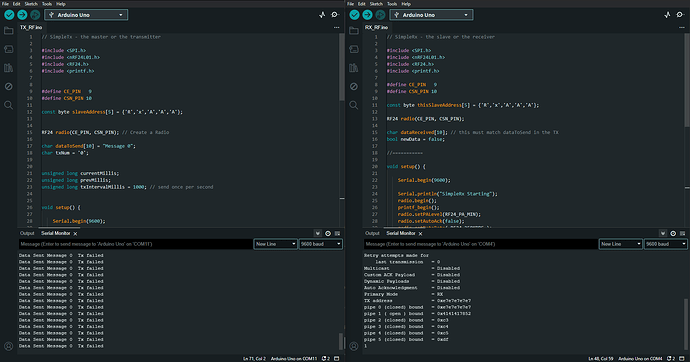

Hi im trying to use the NRF24l01 to receive data wireless from 1 arduino to another.

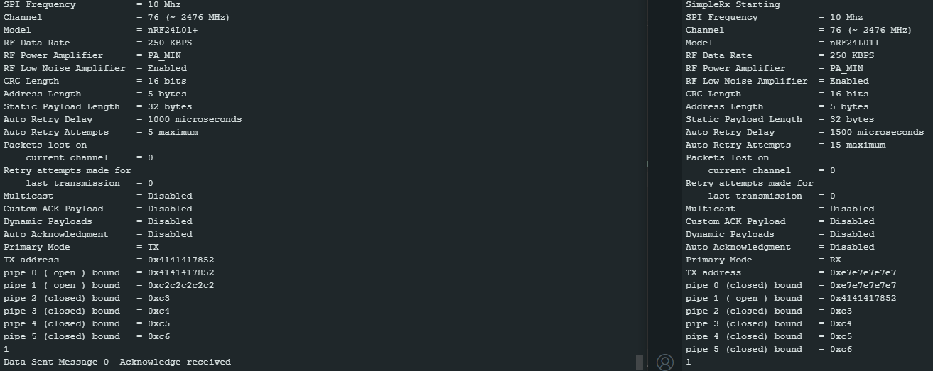

i have used Robin´s tutorial for testing the devices, but i can´t get it to work. it does not recive any data at the receiver side and also says the transmission failed at the transmitter side
i have also tried to add radio.setAutoAck(false); which does make it say that the data was sendt, but still nothing on the receiver side
the data from the IC´s both look fine
and both devices are powered from an external 3.3V power supply. Both devices also have a 100µF cap in parallel to the supply.

An inadequate power supply causes many of these problems.
Robins tutorial has a rather misleading diagram:
which does not really make it clear that the grounds of any additional power source must be common also to the Arduino and the radio module.
See also here: RF24/COMMON_ISSUES.md at master · nRF24/RF24 · GitHub
Incidentally, where possible, post text instead of screen shots.
i know the PSU i am using is good enough.
Its a psu i use for almost everything im doing and is able to souce 16Watt at 3.3V.
i have connected the supply correctly with common ground between the NRF24L01 tranceiver and the arduino.
thanks, will try to look at the things from that link. Definitely thinking it can be a noice problem or a problem with a bad ic batch.
it was easier to post a picture showing that there is no data at the output than writing how it looks
Ended up trying to buy some new modules, and ended up working on the first try. Might have been bad ic or one of the devices that did not work from production
