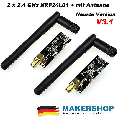

Im using these modules with antenna:

Do you own two of the standard modules?
These do work in proximity.
Sometimes touching the modules/antennas can make it work.
