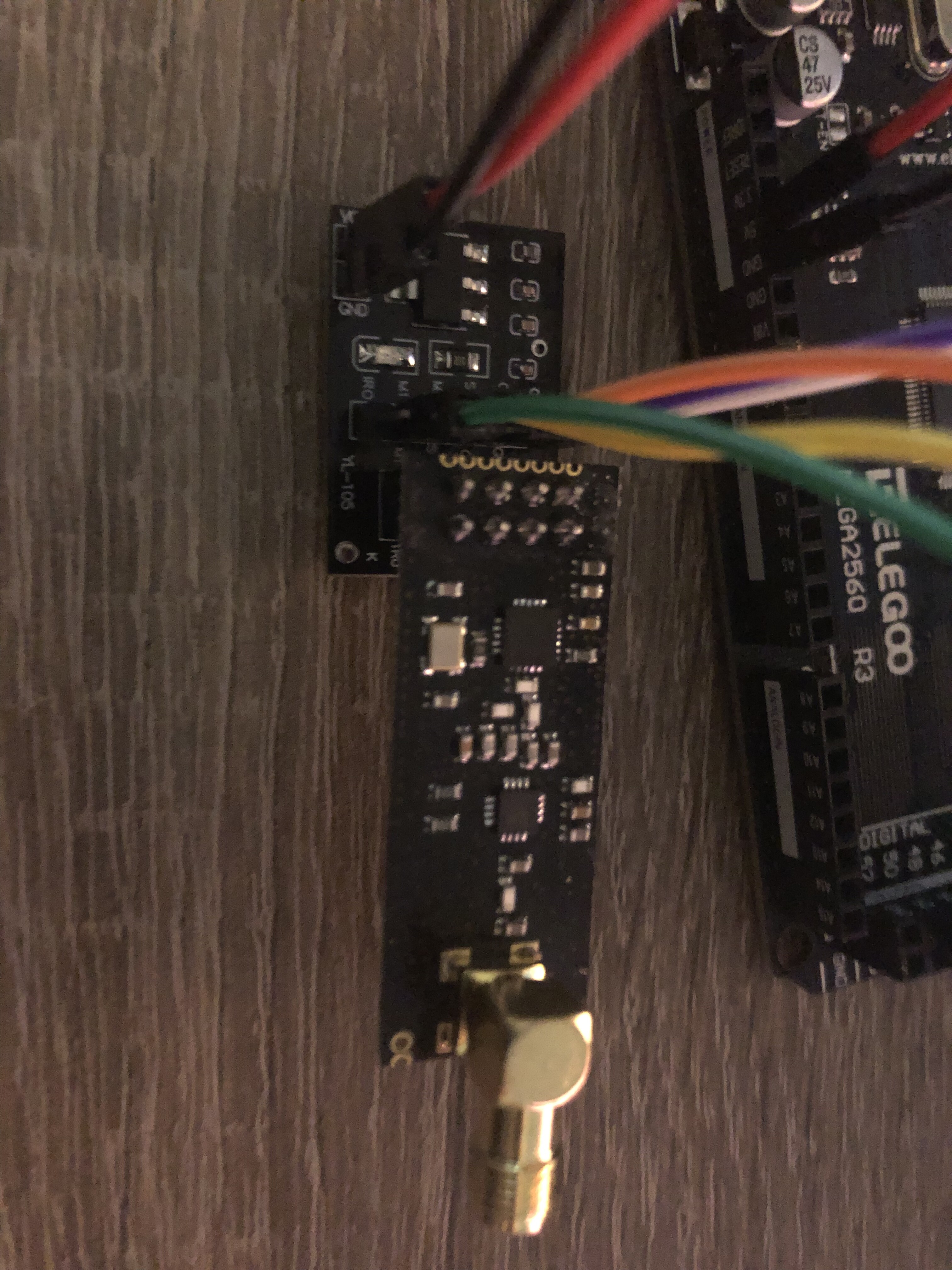

Hello,
I've been trying to get my NRF24L01+PA+LNA up and running for a few days now, but unfortunately it's not working. I already had it running once, but then tried to convert it from an arduino uno to an ELEGOO Mega2560 R3 and since then it doesn't work anymore. Also tried to build it back to the Arduino Uno but that doesn't work anymore either.
I would be very happy about help.

Did you change the CE and CSN pins in the example code to match your setup?
How are the rf24 modules powered?
Yes, my CE pins are both on PIN7 and CSN on PIN8. I use the 5V from the Arduino itself because I use the "Breadboard Breakout Adapter" and I read that it needs 5V.
Adapter like this? I make my own adapters just like that and they work very well. They provide the needed power.
yes, thats the one I use
In Robin2's tutorial in reply #30 is the check connection test code. That code provides a way to test the electrical connection between the rf24 module and its attached processor (not wireless connection). It may be worth running the code on your Nano and Mega to check the physical connections.

Thanks again for the help. Unfortunately this does not work either. I tried to recreate it exactly the same way, only I used the high power RF24 radio modules. The transmitter consistently gives "Tx failed". What does this mean/how to fix it?
Do you see anything on the serial console of the receiver ?
The message you got may only mean that the ack failed to get back from the receiver to the transmitter.
In the receiver console there is only the message "SimpleRx Starting". Nothing else.
Is it possible that one of the parts is simply broken? Even if the test from #8/#10 works?
It is, of course, always possible that one or both units is faulty in some subtle way
You can try these tests
  1. remove the screw-on antennas from both radios.
  2. comment out the following 2 statements on both the receiver and the transmitter
   radio.setDataRate( RF24_250KBPS );
   radio.setRetries(3, 5); // delay, count
Some models of the NRF24L01 don't support 250KBPS.
If that still fails, provide a good close up picture of your NRF24L01 modules.
However, then, the most likely cause is a power problem.
Unfortunately still does not work.
