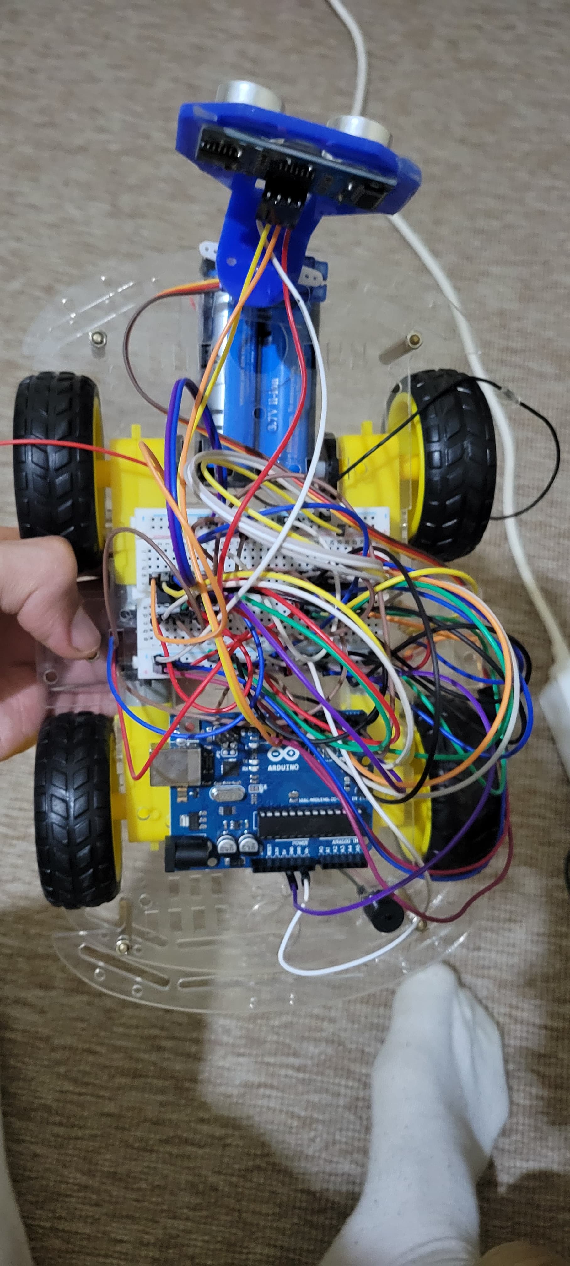

Obstacle avoiding car - Ultrasonic sensor only detects 1/4 of obstacles
Either the surfaces are insufficiently sonoreflective, or the sensor is malfunctioning, miswired, or underpowered.

Might I suggest disconnecting everything from the Arduino, except D11, D12, GND, and 5V going to the HC SR04 (bypassing the breadboard, if possible), and then using some hard, flat surface as a target to test your pulseIn() return values — ideally, using a simplified sketch that only reads the sensor (and outputs to the Serial Monitor), doing nothing else?

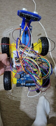

Thing is i have my project dissertation next Friday, and next week is an exams week lol. I m afraid if i mess up too much with the circuit i might have a worse result..
One thing i noticed though! is when the robot is only connected to the LAPTOP (no connection to the Lithium battery), the motors don't turn the wheels. but the captor seems to work a lot better. it seems almost perfect, it detects 95% the times i put my hand on it..
The circuit is already a total mess and will never be reliable.
Loose wiring is certainly one of the problems.
Seems like you are powering both the Arduino and the motors from the same 6-V battery pack, is that correct? And the 6-V battery pack is connected directly to the Arduino 5-V pin, correct? These two mistakes could explain your problems.
Indeed i am using 3.7V Li-Ion X2. But they are connected to the breadboard +/-. Arduino's 5V is also connected to the +- of Breadboard.
Really?
Microcontrollers are meant to communicate over short distances on a circuit board. You have about five meters of wire. This will hinder "good" connections.
Yes i get it but what am i supposed to get rid off? just the 2 drivers have 14 connections each..
The Arduino 5V pin should generally not be used to connect an external power supply, as this can damage the board; use the VIN pin or the barrel jack connector instead. Also, the Arduino power supply should not also power the motors; you need two independent power supplies. The grounds should be interconnected, but not the :plus: voltages.
Number of wires is not the issue (it must communicate), but length of the conductors. Changing all for shorter wires will give you the chance to verify they are all connected to the right place, rather than glancing at it and concluding, "looks good" (when it is not).

The :plus: from the 3v7×2 should only be connected to the servo :plus: pin and to the VCC2 pins on the two L293 D drivers, and nothing else. The Arduino should be powered via a separate source (7–12V), connected to the barrel jack or to VIN. I think that will fix your issues.
Why are you continuing with random guesswork? See Post #25, #15, #7... and I have already used and proven the "old code" from Post #1 worked (removing delay() and servo() statements) in Post #12. Why ignore advice and randomly guess? Be systematic. Read, act, observe and report on every suggestion.

I m looking into your servo() suggestion still sir
POST #25 i cannot apply it, it's risky to redo it all over again sir when i don't have much time before my dissertation!
Thing is now, captor works VERY FINE with this code, but only when connected to my LAPTOP. Not so much when it's the battery that's powering it..
