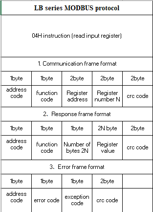

. I have documentation about the sensor's MODBUS protocol but I am unclear on how to utilize it with the libraries available as they cater towards another rs485 to ttl module that has the pins DI DE RE RO .
Can I use the Rx/Tx pins available on my ttl module with existing libraries such as Modbus Master.

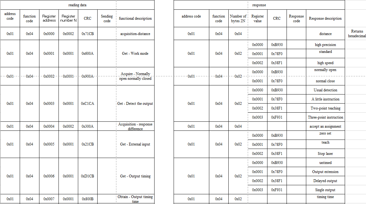

How do I access the sensor data using the given documentation about addresses and function codes.
Any coding that I can refer to either create my own library or to read the data directly from an industrial sensor with an RS485 is appreciated.

The PDF you provided doesn't detail the RS485 comms as far as I could see. You need to know details such as baud rate, parity, stop bits etc. If the sensor is configured to be a modbus device, then you also need to know what device address it is configured for as well as the register address(es) that need to be read from in order to get a reading out.
That would detail the modbus comms parameters. Can you provide a link to it?

these are the key information:
baud
key
this is the memory adresses:
yes i am using a MEGA 2560 Board
https://drive.google.com/drive/folders/1GMYfz7dRgJCBRIeMY-ftNGqMO4G6ELoI?usp=share_link
u can get the documents from here.

2 changes are immediately apparent.
Your device requires a baud rate of 115200, so you need to change your baud rate value accordingly. Change:
long modbusBaudRate = 38400;
to:
long modbusBaudRate = 115200;
The other serial parameters are 8N1 (data bits, parity bit & stop bit). Comment out the line:
Serial1.begin(modbusBaudRate, SERIAL_8O1);
and uncomment the line:
Serial1.begin(modbusBaudRate);
