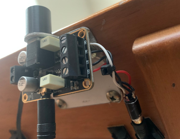

A coupla images showing the project.

I see on the first image you have tied the two speaker negatives together.
Can't do that, because speaker negative is not ground.
You effectively have shorted out the left and right outputs of the amplifier.
As I tried to explain before, the four outputs terminals of this amplifier are all outputs.
Leo..

Connect ground of the headphones to ground of the board.
The easy place is power negative.
Connect a 220uF cap between Left(+) output and Left channel (tip) of the headphones.
Connect a 220uF cap between Right(+) output and Right channel of the headphones.
The (-) outputs are not used for headphones, only for speakers.
The positive side of the cap towards the amplifier.
Leo..

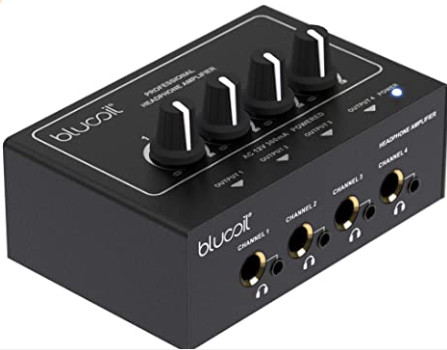

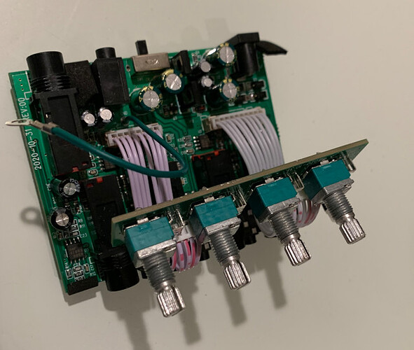

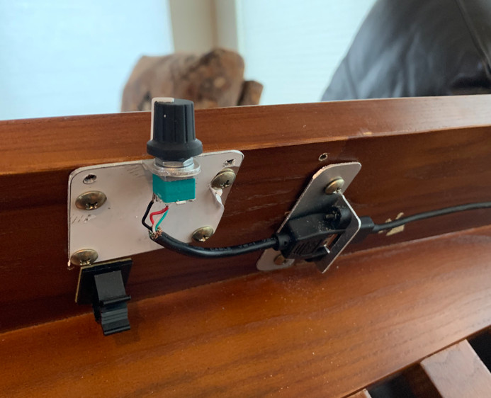

(Solved) While I was never able to eliminate the 'pop' when turning the TV on/off using the Pam8406 amplifiers I did stumble across a solution that works. I purchased (under $10) a blucoil 4-Channel Headphone Amplifier just to try something different. Since I wanted to retain the convenience of individual volume controls mounted on the arms of our chairs, I removed the controls from the body of the blucoil, spliced in USB extensions and mounted them where the PAM8406 unit were originally mounted. While this resulting in simpler wiring to each chair (originally, 3 cables [audio input/output and power], to a single 4-wire cable) the main purpose was to see if this solution would eliminate ALL 'pops'. It did. Of course... I don't know why!
