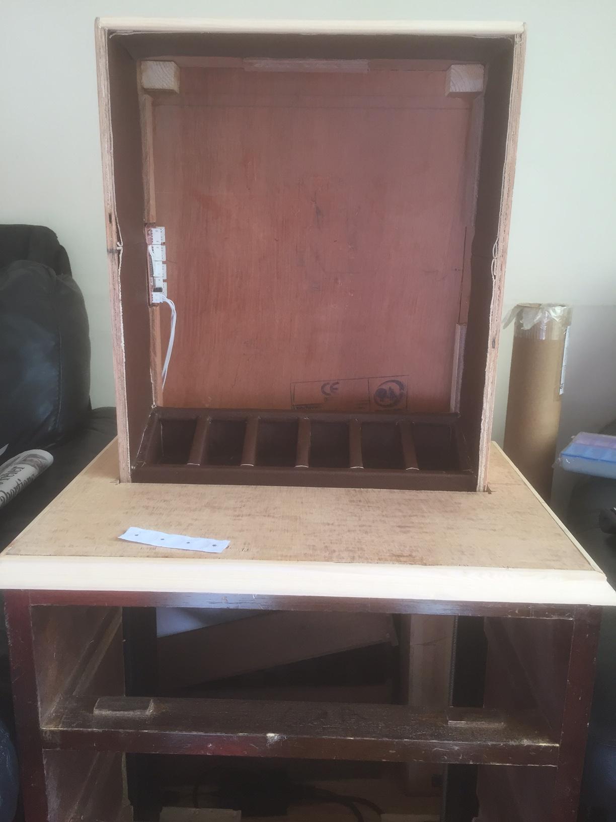

Hi folks, new to this type of thing and have built a watch cabinet which has a lift mechanism which comes out of the top of cabinet powered by a Nema 23 stepper motor. ?need to code for push button operate the lift of said cabinet aprox 40cm stopped by a limit switch then push button again to lower back into cabinet which will be stopped by a second limit switch.

Thanks Robin2, The project is simply to
lift the above cabinet out of the carcass when a button is pressed
to hit an upper limit switch which then stops the motor
press of the button again to reverse the motor to lower back into carcass
hit the lower limit switch to stop
I would like to use 1 push button for up and down. ? would I need to code to clear any input to the button after it is pressed so as to use it again to reverse the action?
I have an Arduino UNO and a Stepper driver TB6560 Mema 23 Stepper motor (as weight of cabinet to lift is 7-8ish Kg)

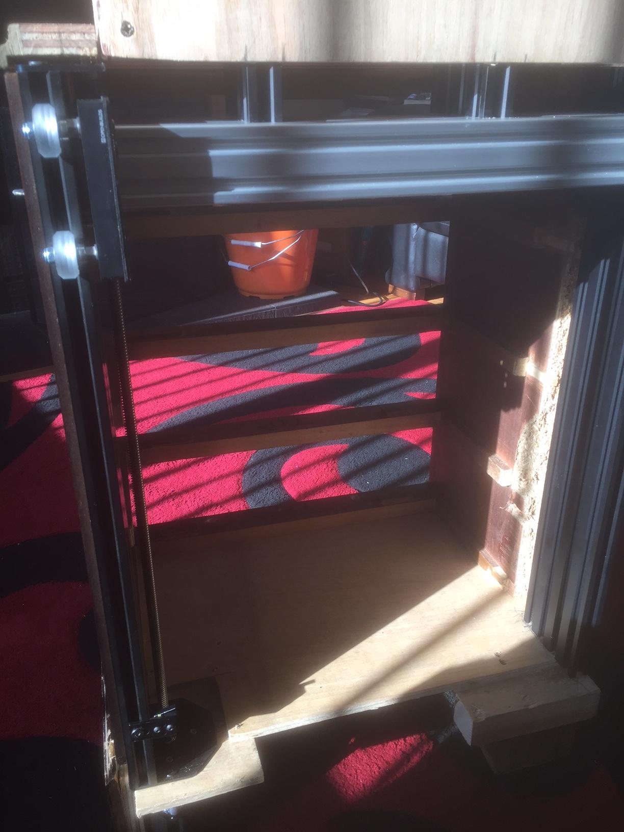

Are you using belt drive then? 8kg isn't hard with a smaller motor using a leadscrew.
Normally for this sort of application (linear actuator with limit switches) a DC motor is a better choice,
but if you have belt drive then clearly need some way of holding position. Normally a leadscrew
or worm gear would be used to give passive position holding, which is safer should the power fail.
