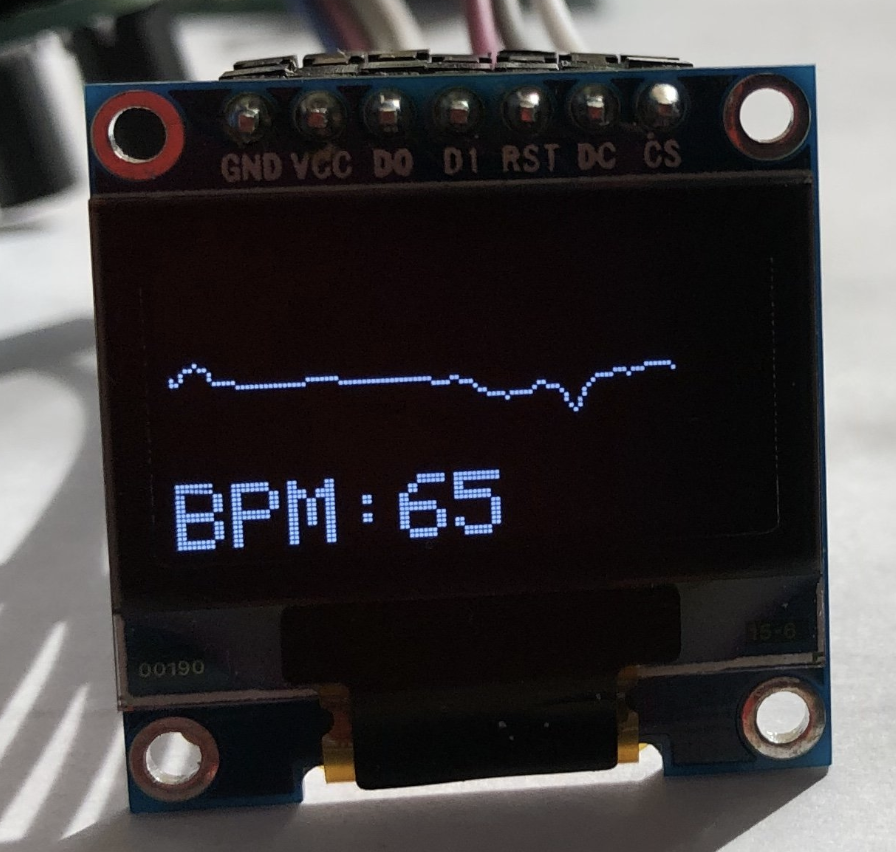

I started following this tutorial here:
which uses a pulse sensor, buzzer and a 0.96" oled display and SSD1306 drivers. Except their display is different. Im using this one:
SSD1306 based OLED connected to Arduino · jandelgado/arduino Wiki · GitHub.
I tried this sample sketch from that SSD1306 site: arduino/ssd1306_sample_adafruit.ino at master · jandelgado/arduino · GitHub

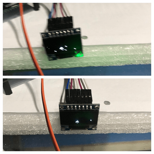

but I only get half of the message on the screen as seen in the image below.
When I upload my final code I get some garbled pixels as seen in the other image below.
Is it a library issue?

ok i just made a change to the ssd1306 library. I had changed the parameter to #define SSD1306_96_16 but I changed it back to the original #define SSD1306_128_64 and it got way better. I do get the right screen now, somtimes. After a few touches it goes crazy:
you shoudt reset it in the loop cycle and display all again at the sensor catch althrou it sams like a power problem is there a 470uF in the circuit to get the signals stable
Do you mean using:
oled.clearDisplay();
Ill try the 470 uF cap and post back.
Thanks
