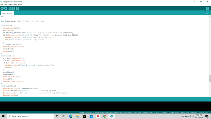

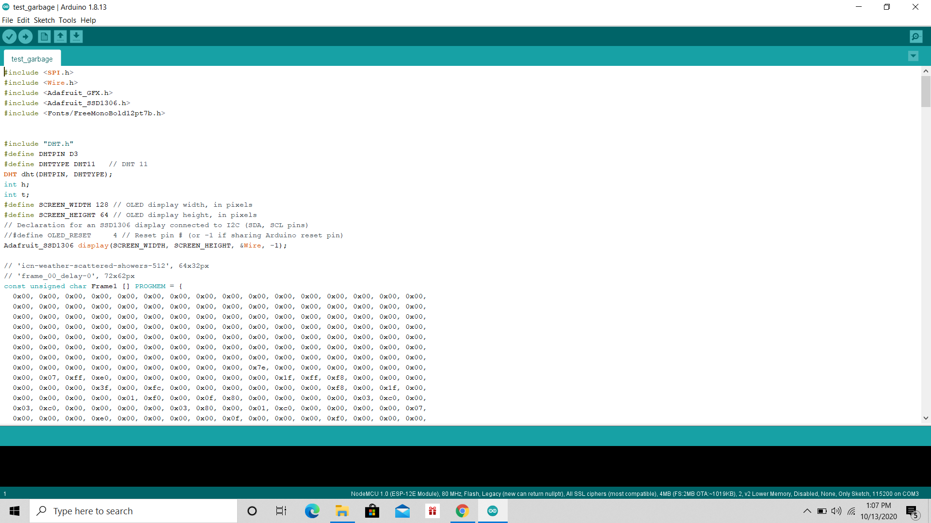

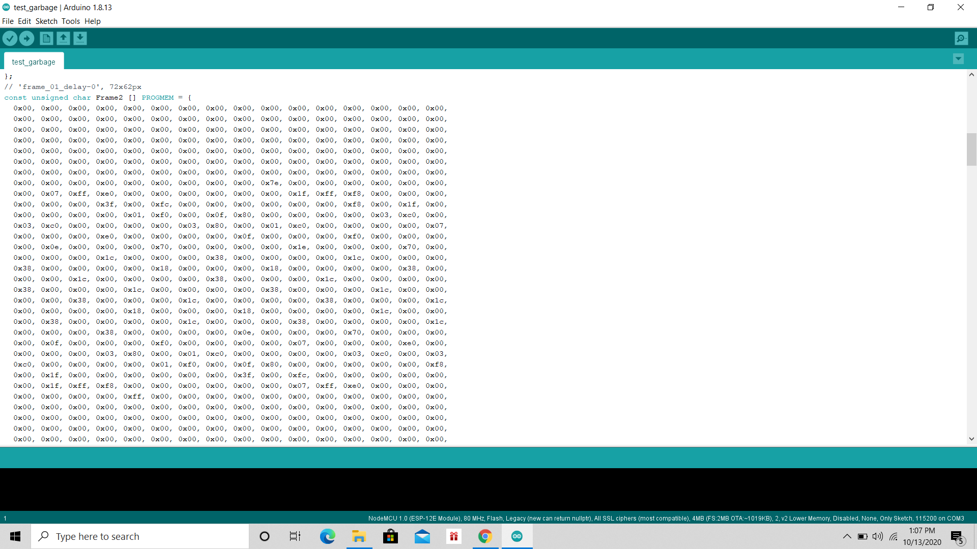

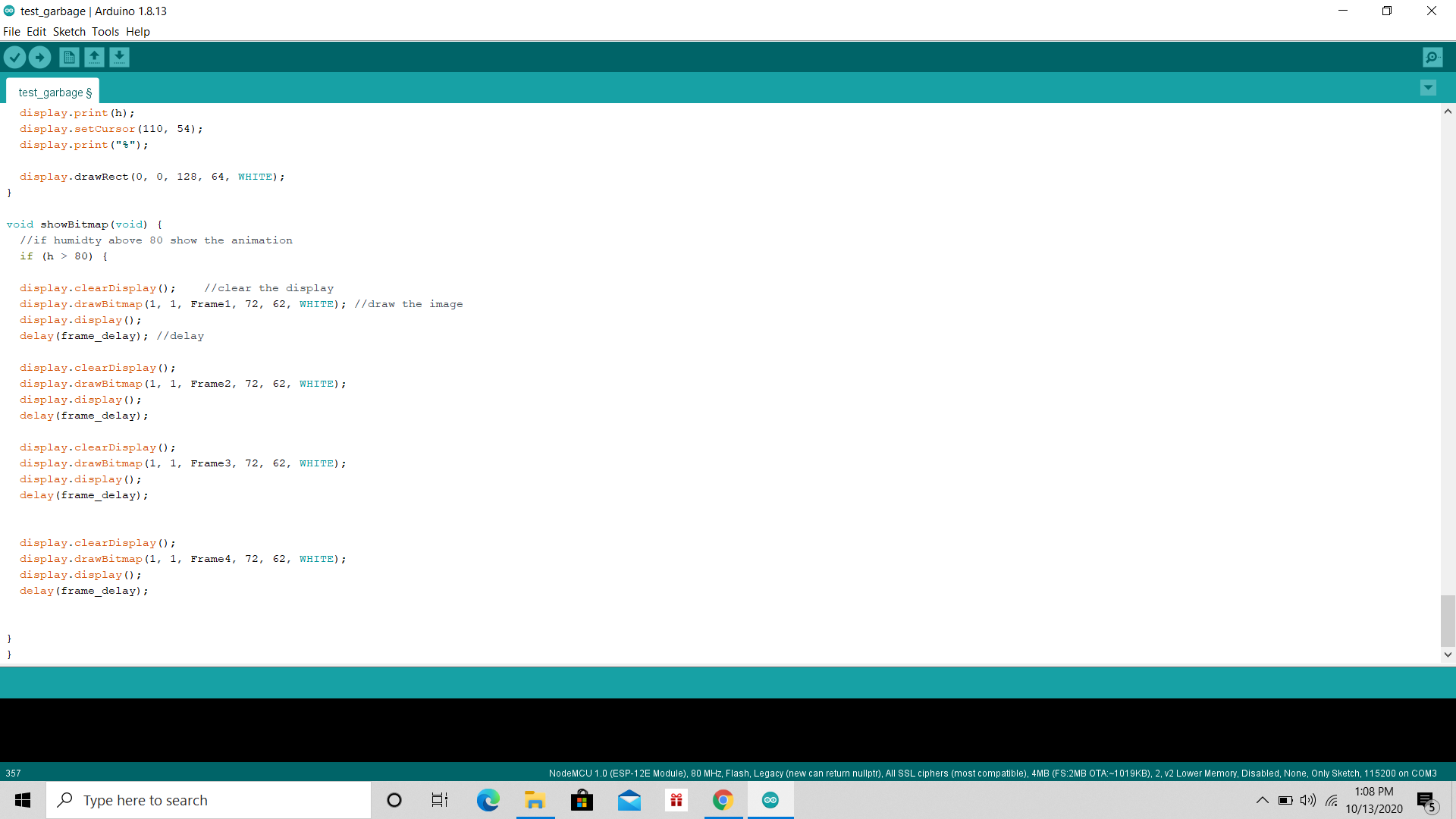

Hi, I am making an ESP-8266 weather station using DHT11 and OLED display. I want to play an animation beside the temperature and humidity values when the humidity is above 80. But when the animation plays the display clear and gives a blinking look with the values. I think the display.cleardisplay is the reason because its clear the display frame for playing animations...Is there any way to plays the animation along with the values if so pls help.
thanks in advance
The in file is given bellow
test_garbage.ino (27.2 KB)
Please don't post unreadable screenshots. A simple INO file attachment is sufficient.

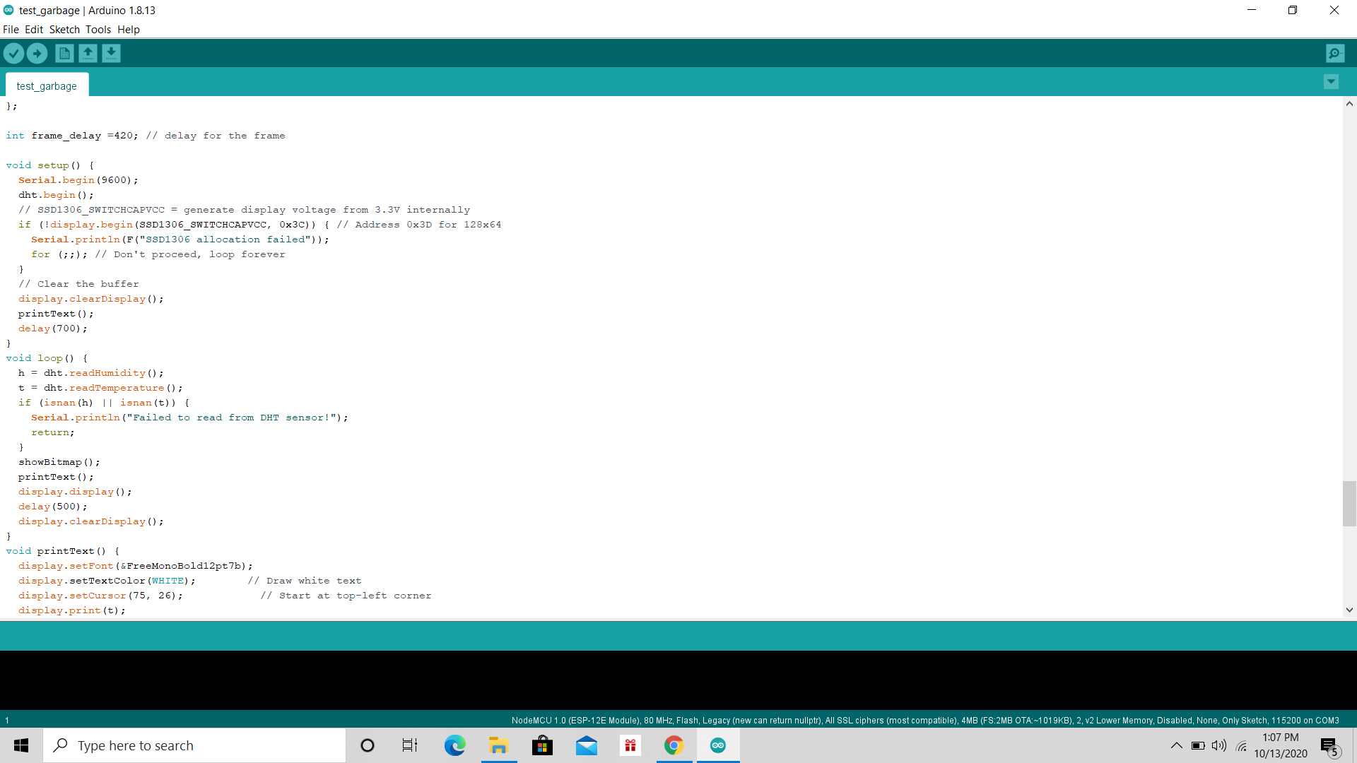

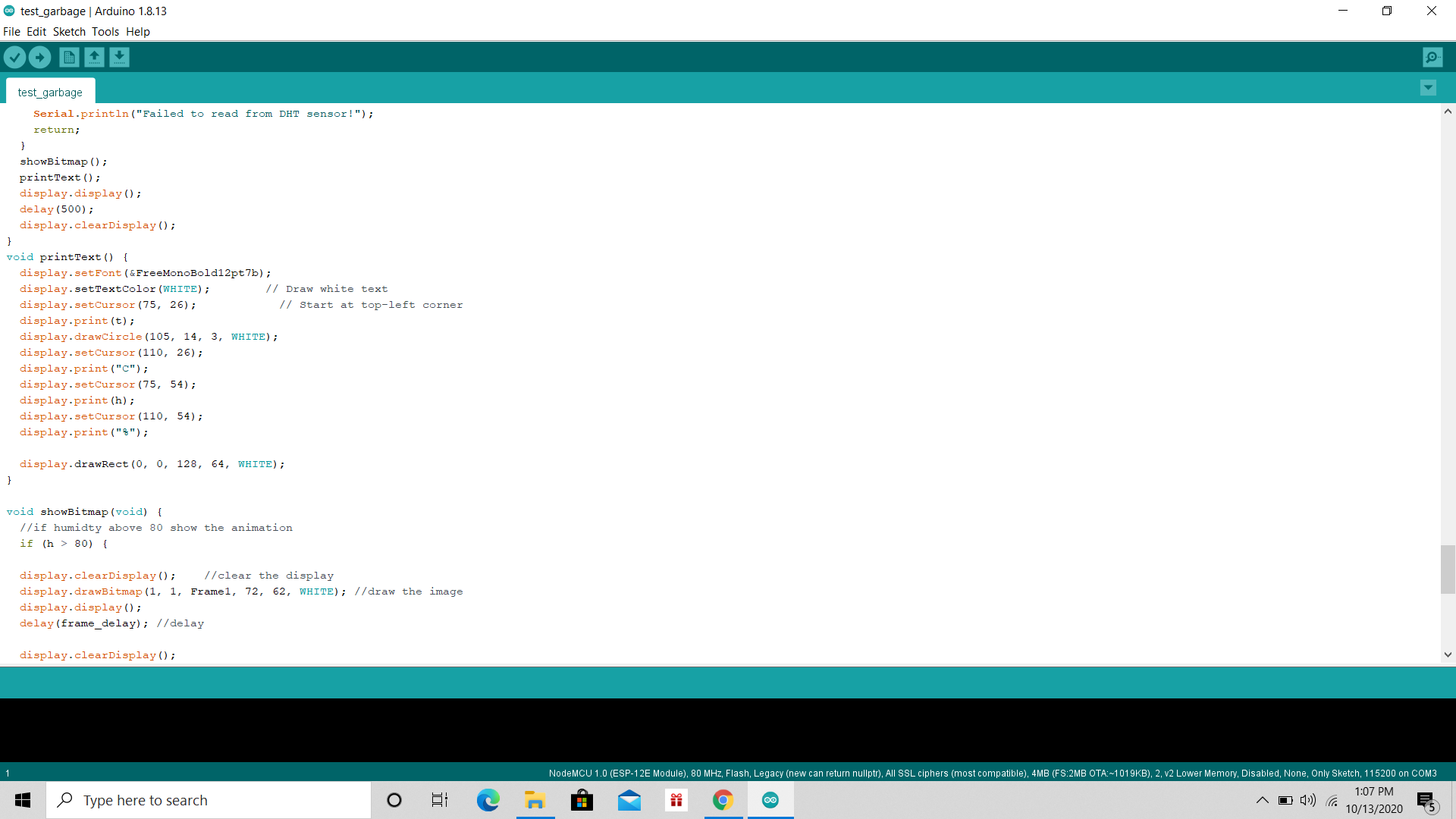

Two problems:
  1. you call showBitmap(); before printText();
  2. you clearDisplay in every frame.
change to
    //showBitmap();
    printText();
    showBitmap();
    display.display();
and
        //display.clearDisplay();    //clear the display
        display.drawBitmap(1, 1, Frame1, 72, 62, WHITE); //draw the image
        display.display();
        delay(frame_delay); //delay

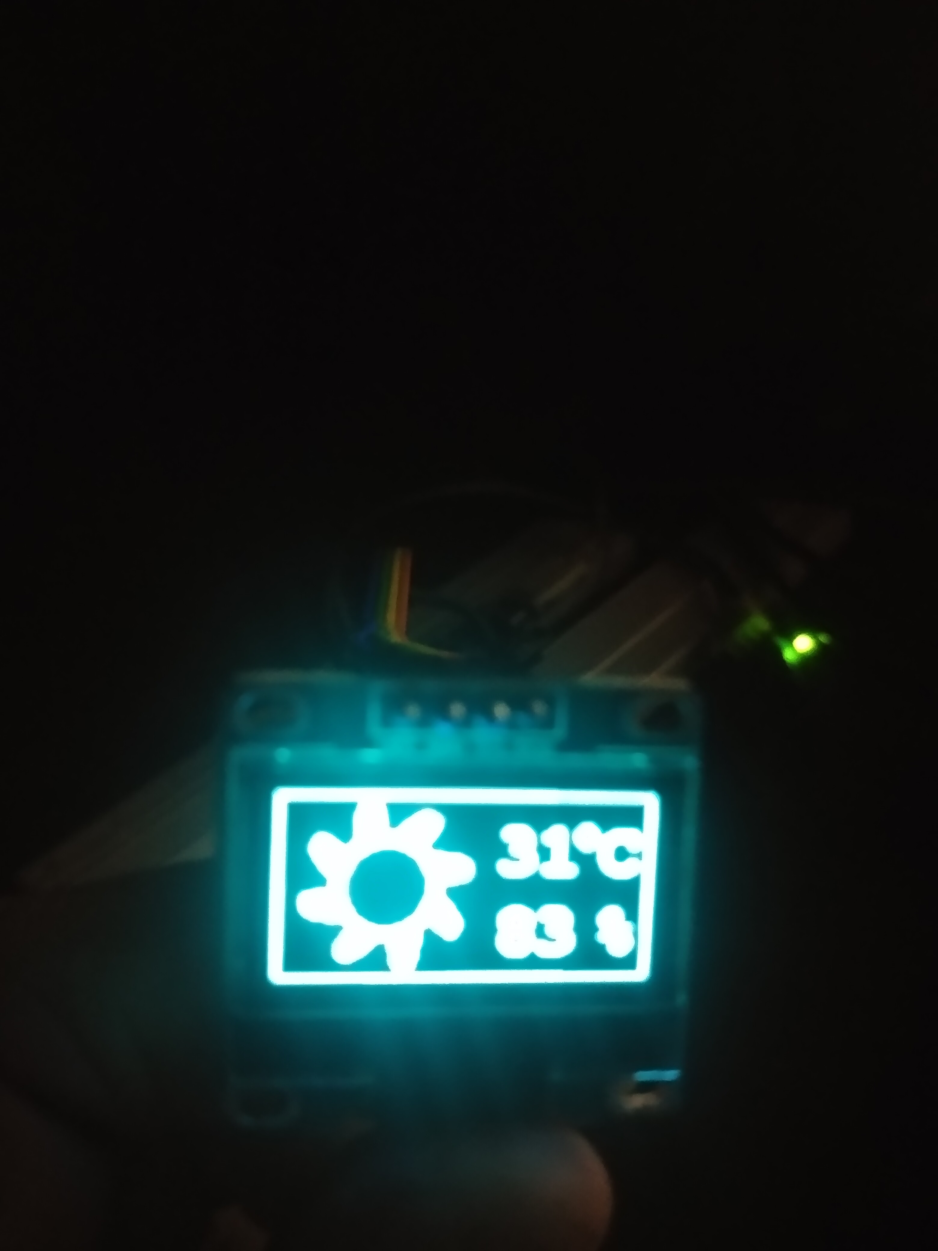

Tried it with an SSD1309 and ESP8266 board. With :
    t = random(10, 40);      //.kbv
    h = random(60, 100);     //.kbv
void showBitmap_kbv(void) {
    const uint8_t *Frames[] = {
        Sunny1, Sunny2, Sunny3, Sunny4, Sunny5, Sunny6, Sunny7, Sunny8, Sunny9, Sunny10, Sunny11, Sunny12, Sunny13, Sunny14, Sunny15,
        Sunny16, Sunny17, Sunny18, Sunny19, Sunny20, Sunny21, Sunny22, Sunny23, Sunny24, Sunny25, Sunny26, Sunny27, Sunny28, Sunny29, Sunny30,
        Sunny31, Sunny32, Sunny33, Sunny34, Sunny35, Sunny36, Sunny37, Sunny38, Sunny39, Sunny40, Sunny41, Sunny42, Sunny43, Sunny44, Sunny45,
        Sunny46, Sunny47, Sunny48, Sunny49, Sunny50, Sunny51, Sunny52, Sunny53, Sunny54, Sunny55, Sunny56, Sunny57, Sunny58, Sunny59, Sunny60
    for (int i = 0; i < 60; i++) {
        display.drawBitmap(1, 1, Frames[i], 72, 62, WHITE); //draw the image
        display.display();
The animation works fine. I strongly recommend that you move your bitmap data into a separate "Sunnys.h" sketch tab.
