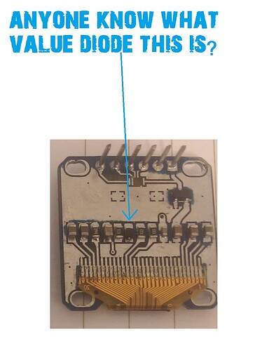

There seem to be a wide range of OLED displays .This model uses a 3V3 LDO Regulator on the pcb.
I would be much happier with a photo of the pcb. One blank screen looks much like another.
However, it "looks" like a 1.3 inch panel. And the printing is unusual. Most 7-pin boards say:
GND  VCC  SCK  SDA RES  DC  CS  ... common boards
GND  VCC  CLK MOSI RES SDC SCS  ... your board.
I suspect that most 1.3 inch are SH1106. And most 0.95 inch are SSD1306.
A rear view of the screen would be much more useful.
The thread title says "but without CS". Your board definitely has CS.
Try the SH1106 examples. Remove the plastic film with Red tab.
David.
Hallo David
I did send 2 attachments but for some reason only the front pic went thru.
Yes it works with the SD1106.
The size is just above 2meg,lets try this see if pdf will go thru .
OLED Back.pdf (281 KB)
Yes, it looks like SH1106.
When you attach photos, you should reduce the size to a few 100kB.
Obviously a genuine text PDF document is already compressed as far as possible without losing information.
Hence you can't attach whole ARM datasheet PDFs. But need to link to an external host.
Note that the SH1106 can't do the SSD1306 scroll functions.
But it can display regular text and graphics. And 1.3 inch is easier to read than 0.96 inch.
