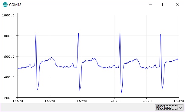

Hello all. I am attempting to use an ECG AD8232 with an OLED SH1106 128x64. The code compiles and I have wired everything correctly but it won't read the loop. The OLED screen starts up and displays the drawPixel but just stops there. I am expecting to see a signal for my heartrate. Are the any insights as to what could be going on here?

If you read the code in setup(), and the comments, you will see why the manner in which you attempt to write to the OLED in the loop() function does not work.
// NOTE: You must call display after making any drawing commands
Have you written code that just uses the serial monitor to see what the ECG part is doing, or not doing?
Read some example sketches that use the OKED you have and see the little dance that making things show up on it.
Once you are up to speed on the two halves of this project combining them should be easier.

The problems with the code are several:
  1. The text colour is never set to white in setup() with a call to display.setTextColor(SH110X_WHITE); as @xfpd noted.
  2. After the display.print('!') in loop, there is no display.display(); as @alto777 noted.
  3. After the initial bits cribbed from Adafruit's example code, the only time anything is being sent to the display is when one of the pads isn't correctly connected, and an ! is sent. At no time is the value of the sensor (from A0) being sent to the display. And in any case, at a 1ms refresh rate, the numbers would be changing so fast that it'd be illegible anyhow -- and you'd likely spend more time than that just to refresh the display.
When you say
are you thinking that you're going to see a graph like the Serial Plotter shows?
If so, you've got a lot more code to add to make that happen. This library might be helpful.

ok I see. I have been able to get a signal onto the OLED with a lot of changes to the code. Those links will be very helpful because the signal is not clean at all. Thank you very much.
Be sure to use the correct library for the SH11xx OLED. Post an image or video of the "not clean" trace... and your sketch. : )
