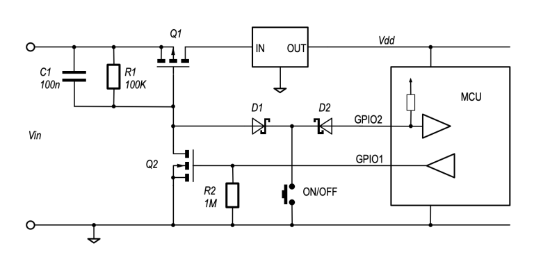

Thank you! I found a very good website (https://circuitcellar.com/resources/quickbits/soft-latching-power-circuits/) where they have descriptions of several circuits. The middle solution would be just right (picture attached). I would like to ask for your help with sizing the components (resistors, capacitors, transistors).
I would work with a 5-volt input voltage and use a 5-volt ESP32 MCU, so I would skip the internal voltage regulator part.

I haven't followed the other thread, but I don't see anything wrong with using the N-channel mosfet. I don't see what the NPN would contribute.
Feel free to help @fl11 with specific parts and so forth for the schematic posted in #4 above.
And make what you will of this
I replaced the N-MOS with a BJT because at T=0 the BJT will be completely off, unlike the N-MOS.
The reasoning offered on the other thread.
a7
I couldn't find a circuit in the other thread where the N-channel would be partially on. So I don't know what he was talking about.
I think the circuit in #4 is fine. If he can find one, a DMP1045U should work for the P-channel, and a 2N7000 or BS170 should work for the N-channel.
The diodes could be just 1N4148 I think.

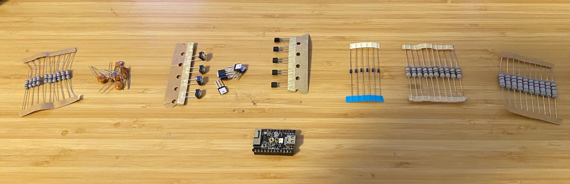

I bought the parts, and in the evening, I will solder the circuit on a prototype board. I hope everything will work well! Thank you very much for your help so far!
In a completely discharged state, a MOSFET floats and will allow one sizable burst of power through when the voltage source is connected. There is a cap that eliminates the width of the burst, but swapping the MOSFET on the gate with a BJT eliminates it completely as it is definitively off in a discharged state and as such provides a determined state for the power switching MOSFET.
I'm still confused. Are you talking about the N-channel mosfet? In the mosfet circuit I found in that thread, it has a pulldown resistor to ground. So it's not floating. Could you point me to the post number in that thread that has the floating gate mosfet you're talking about?
If you're talking about the P-channel mosfet, then yes, when power is first applied, it can turn on because the gate lags in coming up. The capacitor prevents that by bringing the gate up with the source, keeping the mosfet turned off. But I don't see what difference an N-channel or an NPN on the gate makes. Either would be off.

I have assembled the circuit, measured everything twice, the wiring is correct, and without the MCU, the circuit seems to be working fine. If I pull the "power hold" pin to 5 volts, it holds the voltage, and when I release it, the output turns off. Unfortunately, when I connect the MCU to the system, I can only successfully turn it on about once in every ten attempts. Without a latch circuit and with a 5-volt input, the "power hold pin" perfectly holds the 3.3V voltage immediately after booting.
The list of components:
bjt: 2N3904
p-mosfet: IRFU9024
Instead of the 480-ohm resistor, I could only obtain a 470-ohm resistor.
Guys!
I did it! I rerouted the Power Hold Pin to GPIO10 instead of GPIO9! All functions are working perfectly! I forgot to mention that the MCU is an M5STAMP C3, equipped with esp32 c3.

I used the circuit of @er_name_not_found , but instead of the P MOSFET, I used a different type, and I used a 480 Ohm resistor instead of the 470 Ohm one. All the other components are the same. The next step is to build a DC-DC boost converter circuit to have a stable 5V output from 2 AAA batteries.
