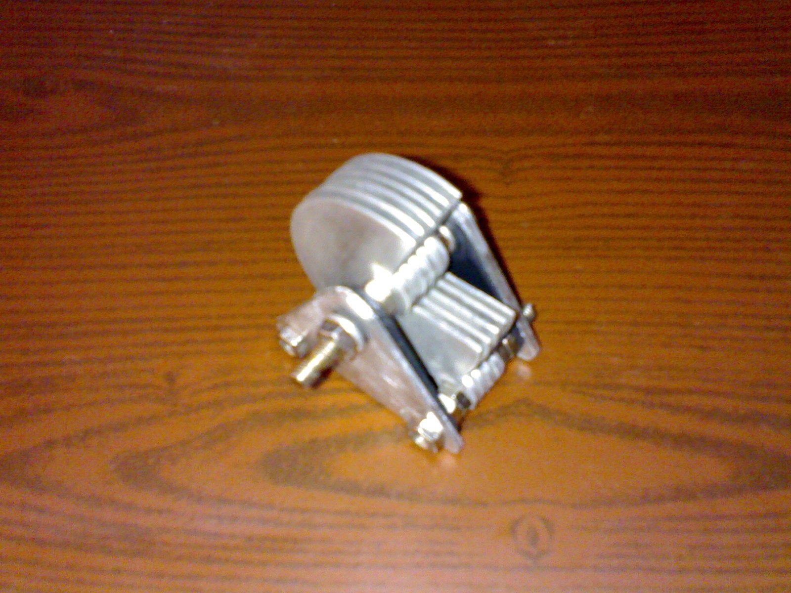

A DiY air variable condenser is here:
I am not happy with excessive craftsmanship of this one, but I will re-design it a more functional manner. Or find an alternative.
https://www.instructables.com/id/air-variable-capacitor-from-scrap-aluminum-sheets/

The ferite rod and the (air) variable capacitor concerns me. Air capacitor is a nice educational solution, because kids can imagine how it works.
