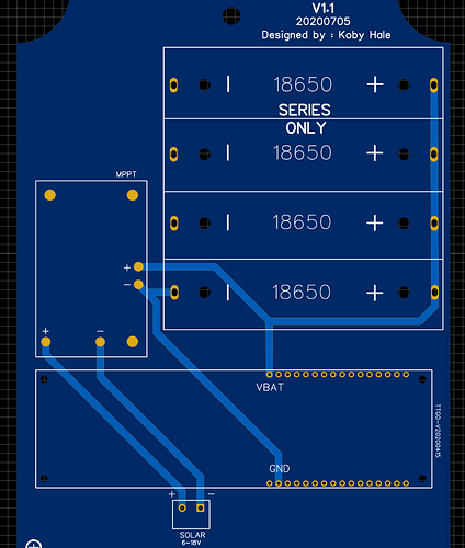

Can you please post a copy of your complete circuit please?
A picture (circuit) is worth a thousand words.
Tom... :slight_smile:
Well as I said its kind of on a PCB

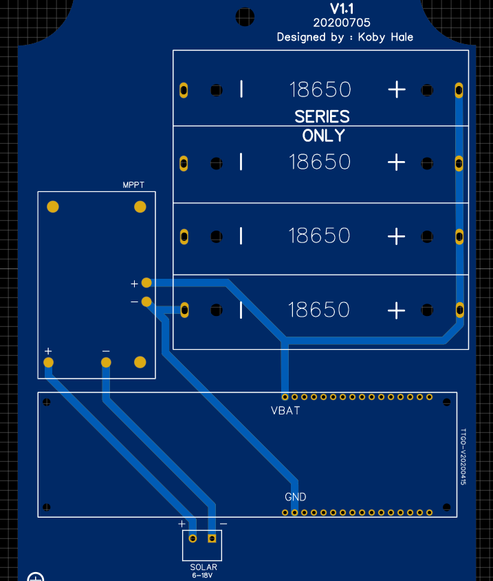

1st photo is a cleaned-up version of the PCB (Removed all but power lines)
2nd is a render that I find easier to look at (Battery - connects the 4 on the back)
Ops pics.
