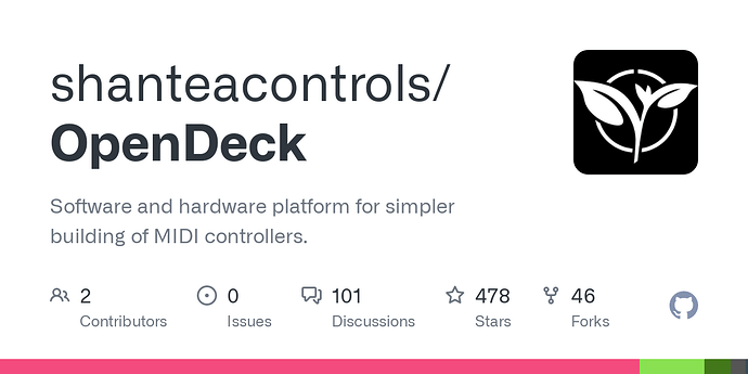

Schematics, PCB design, source code, part list and documentation is available on GitHub:
