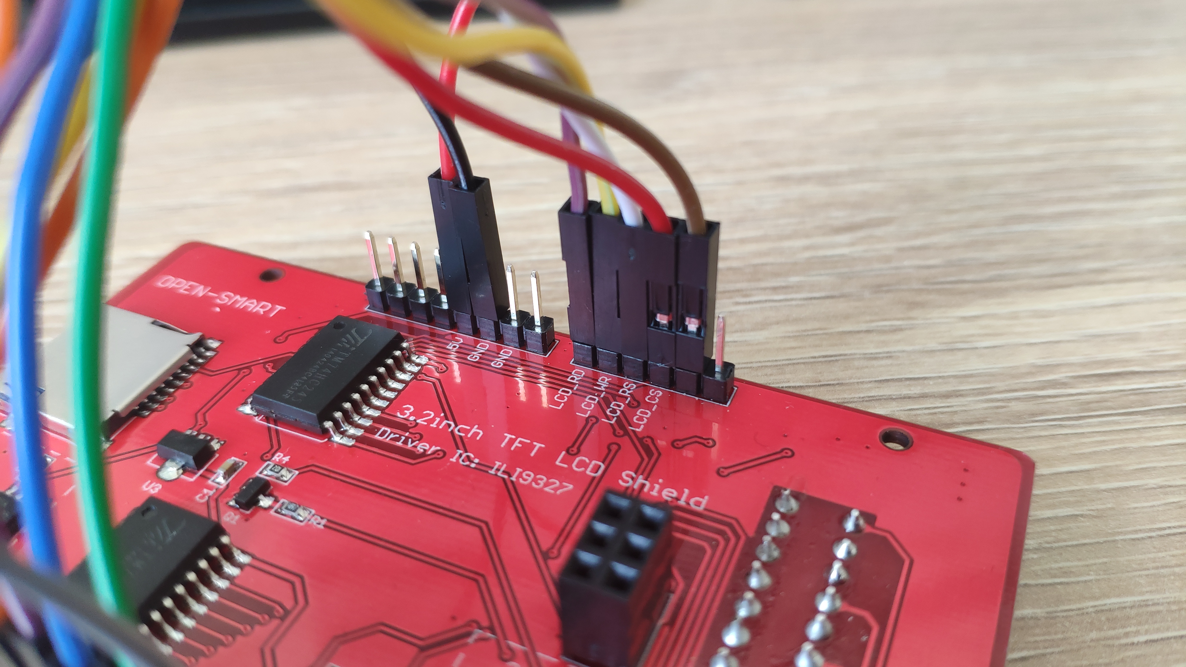

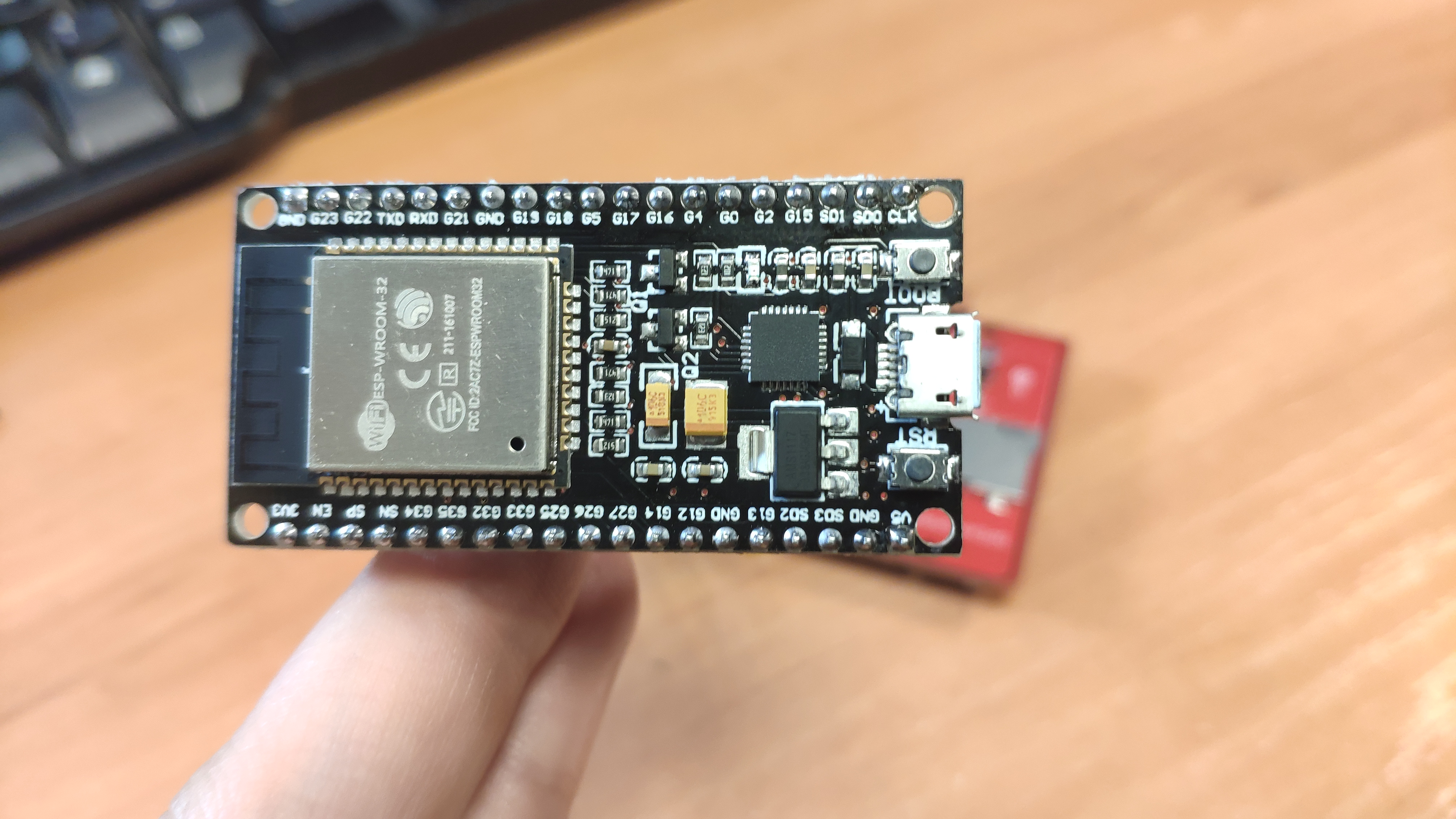

beubeu
April 25, 2020, 8:48am
8
I rewiring and re-tested, but same result.
I attached pictures, but it is a little difficult to show all wires with pinout attached !
I don't understand I retested the screen on my 2560 and all is OK.
The only "problem" is that I have no RESET pin on this shield screen. So I used the pin below LCD_CS because it is the defined pin in the OPENSMART lib (A04 on the 2560 board).
Surely you could show a photo with coloured wires on the Shield.
And a photo with coloured wires on the ESP32
Even better. Add the wire colour to each define e.g.
#define LCD_RST 32
#define LCD_CS 33
#define LCD_RS 15
#define LCD_WR 4
#define LCD_RD 2
#define LCD_D0 12 //violet
#define LCD_D1 13 //orange
#define LCD_D2 26 //...
#define LCD_D3 25
#define LCD_D4 17
#define LCD_D5 16
#define LCD_D6 27
#define LCD_D7 14
This will make your checklist easier to follow.
And possibly more likely for a reader to assist.
There is no LCD_RST pin on your shield. Just define as any unused pin.
When your wiring is correct the readreg sketch will report the correct values.
David.
beubeu
April 25, 2020, 9:24am
10
Yes
Corresponding to the pictures in my previous post, colors are :
#define LCD_RST 32 //brown
#define LCD_CS 33 //red
#define LCD_RS 15 //white
#define LCD_WR 4 //yellow
#define LCD_RD 2 //purple
#define LCD_D0 12 //purple
#define LCD_D2 26 //yellow
#define LCD_D3 25 //orange
#define LCD_D4 17 //grey
#define LCD_D5 16 //blue
#define LCD_D6 27 //green
#define LCD_D7 14 //blue
Nothing in Arduino IDE could be the root of the issue ? Maybe a bad configuration... I selected the ESP32 DevKit board, and change nothing in the config menu (flash mode, speed etc..)
Yes, your colours match. Now you check that it is the same wire that joins.
Seriously. A paper checklist and a pencil will be a good investment.
