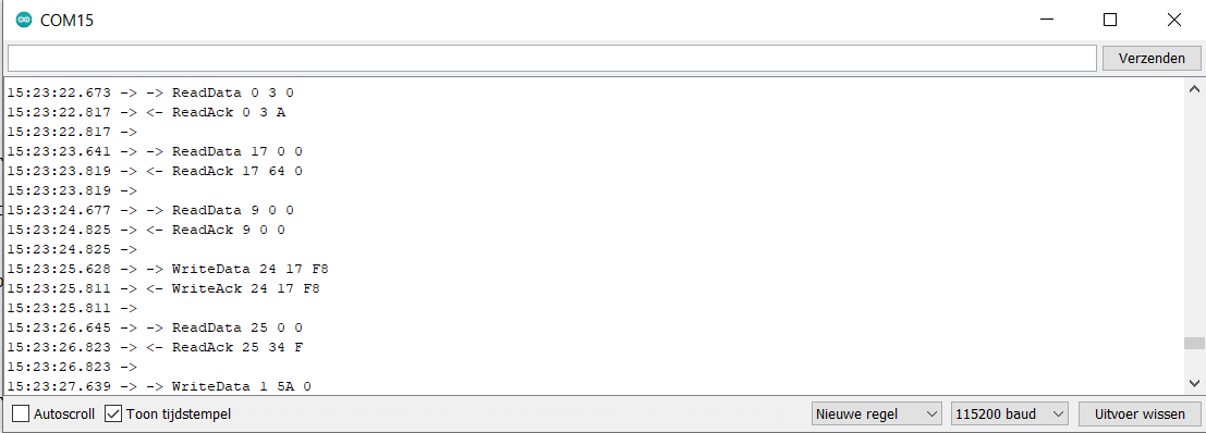

For a project we want to be able to monitor a boiler via OpenTherm. I got the shield from Jiří Praus and it works.
Only the data i am seeing in the serial monitor doesnt match. For example, when i request data ID24 (Room temperature) the thermostat shows 24 degrees and in the serial monitor it says 17F8... It does this with some other values too.
Is there someone that can help me get the right values? Or tell me what i should do?

![Schermafbeelding 2022-04-05 152643|690x248](upload://jdn6gL5QQB9PKVnZRm7ZvNbtT0S.png)
could 0x17f8 be 23.248degrees?
give some more examples?

Another example was getting the value for the feed water temperture. I get following: 27C5 and 27DC.
Could you explain how you got the 23,48 degrees out of the 17F8?
non-integer values are often represented by integers multiplied by a constant which is often a power of 2. horace was quick to not that 0x17 is 23 decimal. the 0xf8 is the fractional value.
divide 0x17f8 which is 6136 decimal by 256
looking at 0x17f8 the first byte 0x17 may represent the whole number of the second byte 0xF8 the fractional component

How can i implement the conversion that all data i receive is converted and readable in the serial monitor?

I for example want to convert the data with ID 25. The first number is the ID (25 in this case) and after that is the data. How can i tell the arduino that he only need to take the data after the ID, convert it and print it as degrees.
I think you can call the f88() method , see opentherm.h
But how can i call the f88() methode in such a way all my data (temps) are gonna be readable?

could you show us the serial monitor output of a run of your program
Dear horace!
I should have posted a screenshot of the serial monitor output already. But i will post it again.

Hi Horace!
I get following error when i try that: 'f88' is not a member of 'OPENTHERM'
this indeed does work! Only thing is that i cant manually put in the values...
f88 is a method in the message, not OPENTHERM itself.
yes i found that out. But how can i use it? I added the f88 function to my code but still cant see the decoded data in the serial monitor.
Could you maybe explain or show it to me?
