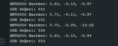

I compiled a code like this. At first it only measured BPM as 59. But with the corrections I made later, I cannot measure the BPM value at all. The MAX30102 sensor light is on. I can also take measurements when I operate the sensor alone. But when combining 3 sensors, MAX30102 does not give any value.

WhatsApp Görsel 2024-06-08 saat 22.58.56_bfcd8bf0
You have configured your sketch to only use the sensor when irValue > 50000:
So if particleSensor.getIR() returns a value of less than or equal to 50000 then that is exactly the behavior we would expect from your sketch program.
What should I do?
Is a value of <= 50000 from particleSensor.getIR() expected?
Is there a reason you configured your sketch code so that the MAX30102 will only be read if irValue > 50000?
Whether it is smaller or larger than 50000 does not change anything. But the code does not work without this condition. I don't have much idea about what happens next.

Actually, I mentioned the general purpose of my project in a different title. Let me talk about it here for understanding. Our project is a smart watch project based on receiving data from 3 different sensors simultaneously. Here we aim to measure BPM and SPO2 with MAX30102. We aim to see human movements with MPU6050 and emotional changes with GSR.
I activated the project's sensors one by one and took measurements. So I measured BPM and SPO2 separately from the MAX30102 sensor. I ran GSR separately. MPU is the same way. When it came to combining the codes, I got help from chatgpt. However, there are errors I get in the merging part. Some of those;
1- MPU and GSR sensors are printing data at the same time. But the MAX30102 sensor does not print.
2-BPM is always the same in codes where all sensors work at the same time.
3- While the MAX30102 sensor measures BPM, it cannot measure SPO2. The SPO2 value is constantly distorted or incorrect.
In general terms, this is the situation.
