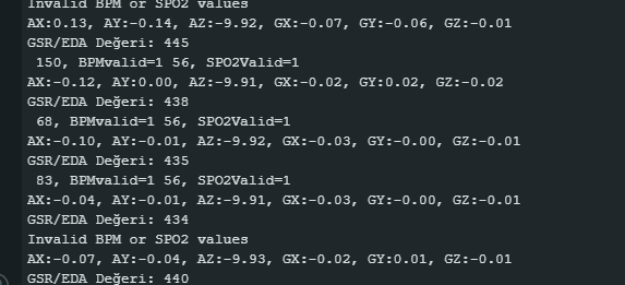

Hello,
I am working with Arduino Uno and Mega for a project assignment. In this study, I aim to get movement data from the MPU6050 sensor, stress data from the GSR sensor, and pulse and SPO2 data from the MAX30102 sensor. All sensors work separately and receive data smoothly. However, when I want to combine 3 sensors at the same time in one code, only the MAX30102 sensor works. Other sensors do not measure or give a not found error. Since Uno's memory is not enough, I use Mega to receive data from 3 sensors simultaneously. I checked all the connections. I compiled the code in different formats, but the problem did not change. Can you help with this issue? RELEVANT CODE IS BELOW
Thanks.

Your topic has been moved. Please do not post in "Uncategorized"; see the sticky topics in https://forum.arduino.cc/c/using-arduino/uncategorized/184.
With the information that you have provided I doubt very much that people will be able to assist. Please provide a schematic/wiring diagram. Please show your code; don't forget to use code tags as described in How to get the best out of this forum.
The GSR sensor should not create a problem here. GSR sensor just gives analog output. I think there is a conflict between the MPU6050 and MAX30102 since both are using I2C communiation. Check your code including the library to see if there is a pin conflict.
I actually ran all the sensors separately. I can measure. But due to the project, I need to receive data at the same time. But even though I check all the links, I cannot reach the result. Anyway, thank you for your support.
Why do you only occasionally use the F macro in Serial.print("some text");?
Here's your same code with it used throughout, does it fit on the Uno now?

I will try it and report back. Thanks.
Currently, we can receive data from all 3 sensors at the same time, but the bpm value is not stable. If we solve this problem, it will be completed.
A quick glance at your code shows you do NOT have a constant time value for computing BPM. Without that time interval being a constant value, the result will always wander about.
So, how can I set this time interval to a constant value?
Perhaps a real time clock? Or use 1000 millis to give a 1 second time when you can compute the number of beats per minute.
Sure, can you suggest a code block for this?
No. You do know how to use millis to make a timer, don't you? If not, it's time for more learning.
