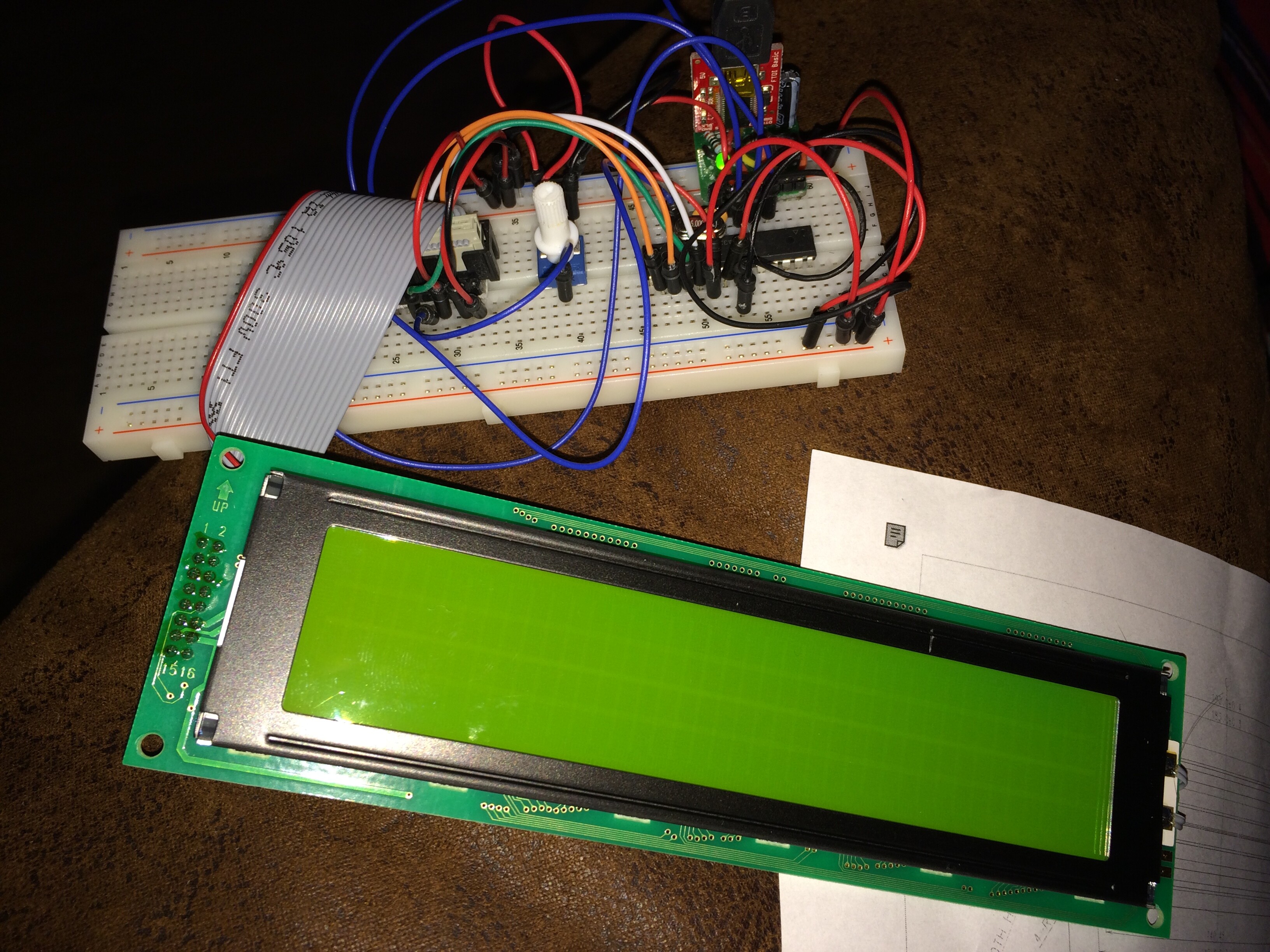

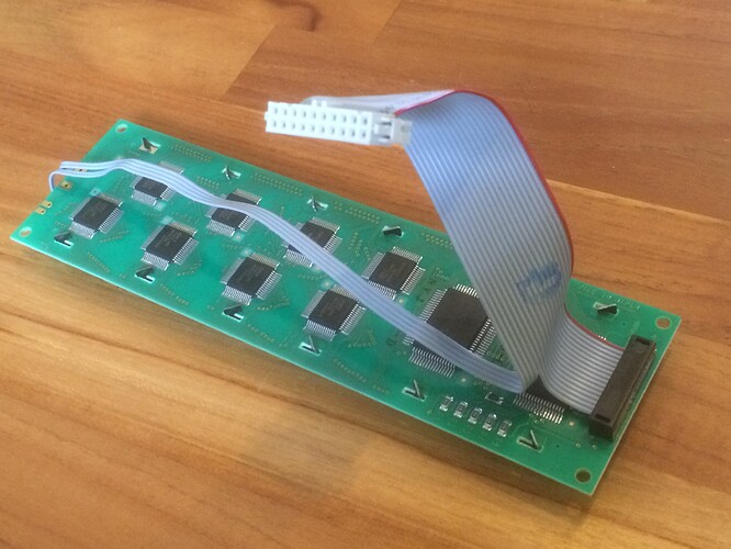

Hi Don,
Sorry for the late response. But thanks for your comment. Here are some detailed pictures.
The ATmega328PU works well.
All the wires are also good and also the breadboard. My idea is that the pinout is wrong?
DMC-40457N.pdf (226 KB)
It may seem to "work well" as is, but without any decoupling capacitors you really don't know. This is especially true when you start operating another microprocessor ( the LCD controller) nearby especially when it is powered by the same supply.
Here is my start at attempting to troubleshoot your wiring. It would help to know more about the ribbon cable.

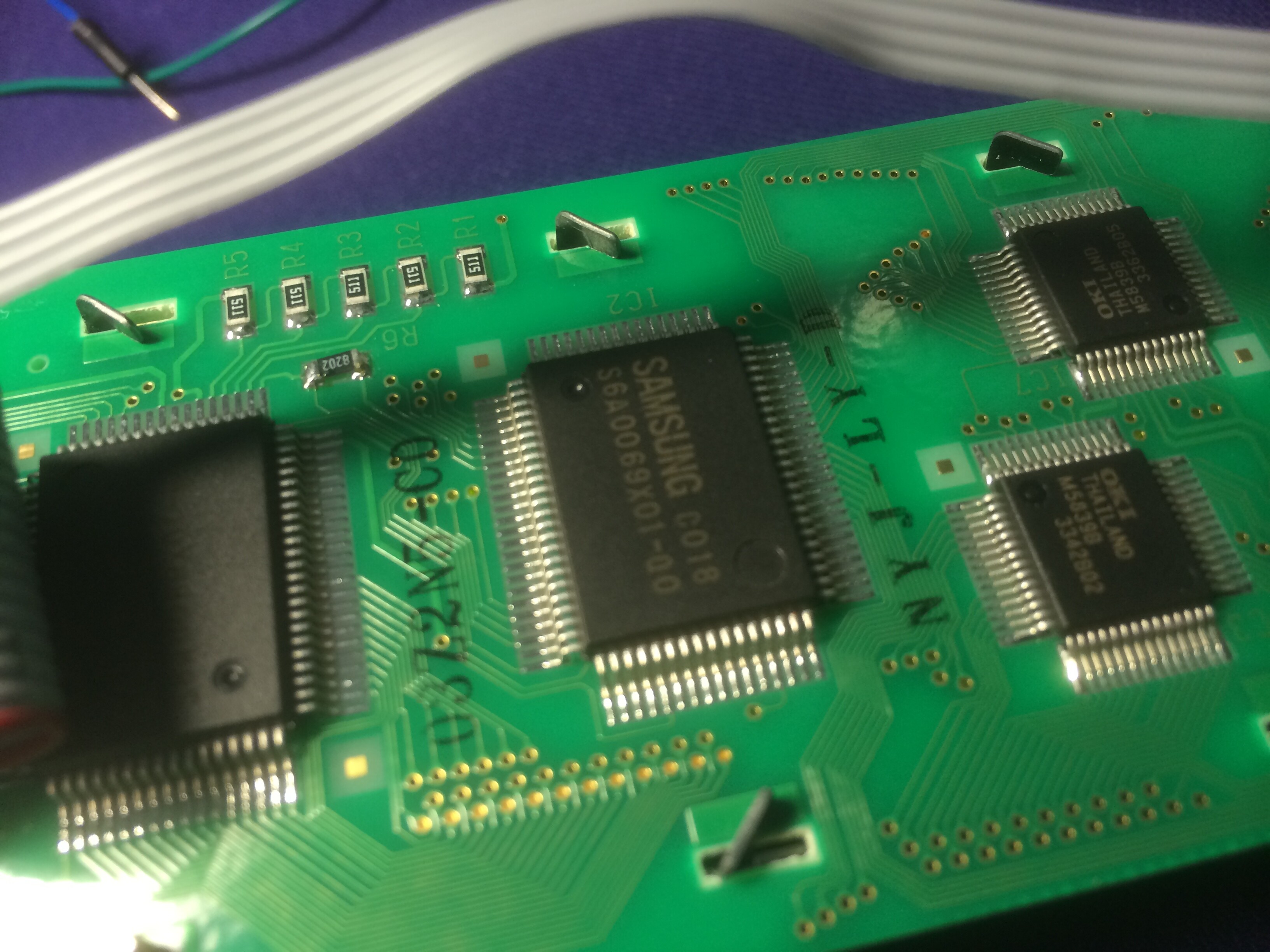

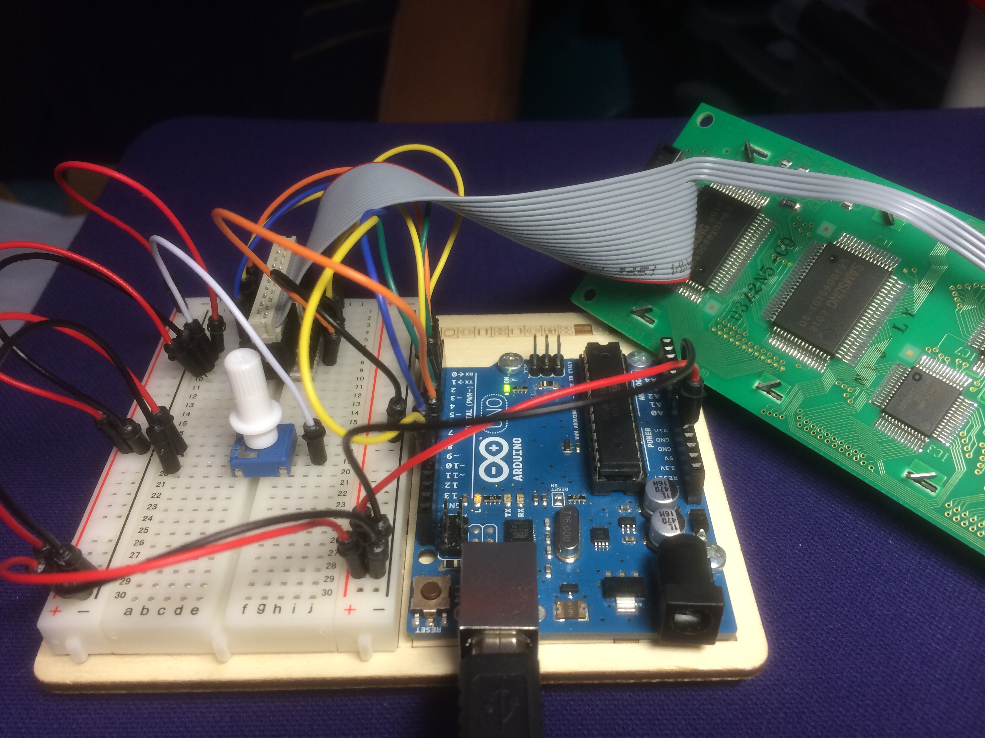

Now I got it connected to my Arduino Uno.
I think I have the wrong data sheet.
My LCD has the "Samsung S6A0069X01" chip's and not the "HD44780".
The S6A0069 is an HD44780 compatible controller. The X01 most likely refers to 'ROM version' which specifies the particular character set in the chip.
