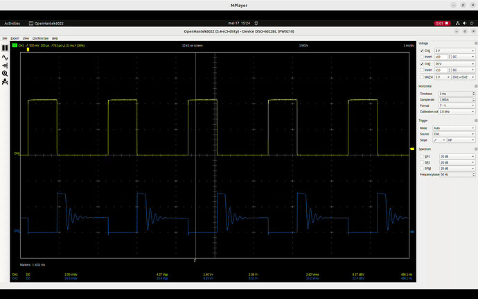

Osciloscope gives strange PWM with DC MOTOR and TIP120
Hi..
A TIP120 connected to a arduino mega 2560 to control a dc motor.
Connected like this :
The yellow square wave comes from a arduino meg 2560 pin 5
The blue wave is measured on TIP120 over collector and emitor.
The blue wave should be a nice inverted wave of the yellow wave.
But the blue wave is a mess.
Why ?????? I can not figure it out.
Thanks...
Vroemm.

Your trace shows exactly what happens when the current to the motor is suddenly stopped!
The sine part, but the flat part after the sine to ?
Surprises me this part is so exactly flat.
This example with a arduino and a TIP120 is several times give on the internet.
But to me, it seems not to work.
Very strange.
Apparently i do not understand it :slight_smile:
Vroemm.
This is from the diode you have across the terminals of the motor.

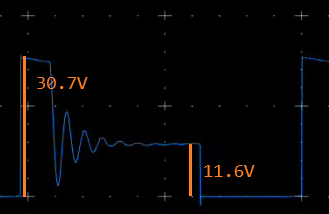

The ringing observed when Pin 5 is LOW appears to have a frequency on the order 10 kHz; if the motor inductance is on the order of a millihenry, this would suggest the resonance is created by coupling to a microfarad-scale capacitance. That is much larger than the diode or transistor capacitances, so perhaps something in the power supply.
No, it will never be an inverted yellow line. If the yellow line is at Gnd, the TIP120 is switched off - high impedance. So what you are measuring is the back EMF of the motor. Between pulses, the motor acts like an unloaded generator. It looks a bit weird because you are measuring the voltage across the transistor and not the voltage across the motor. The motor voltage is the difference between the blue line and the 12V supply.
There may be a small amount of back-EMF contributing to the measured signal, but as shown in the annotated oscilloscope trace below, after the ringing has subsided, the back-EMF appears to be no more than 0.4 V (assuming that the "12-V" power supply does produce 12.0 V).
On the other hand, the initial 30-V spike is unrelated to back-EMF — this is caused by the inductive spike resulting from the abrupt change in flux linkage in the armature coil.

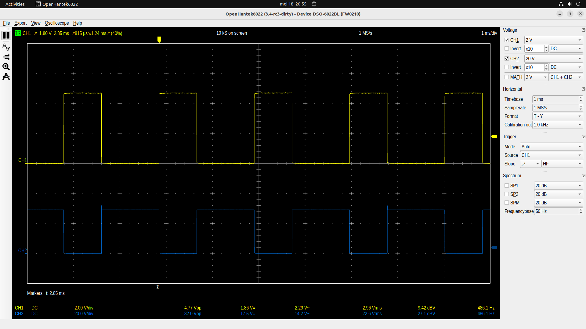

Instead of a light bulb, i tried with a 200 ohm resistor.
Gives perfect blue square.

My point was that the back-EMF is going to be smaller than the driving voltage, so the collector-emitter voltage difference initial part of the response should be lower than 12V, unless the motor is reversing direction. The much larger voltage pulse seen in the oscilloscope trace therefore would not be explainable by back-EMF, unless OP is not telling is the full story (which the resistor test suggests is the case).
The top of the blue line is 30 volt which is the power supply..
There is no 12 volt power supply.
The second blue horizontal line voltage varies, depending on the pulse width of the yellow line.
