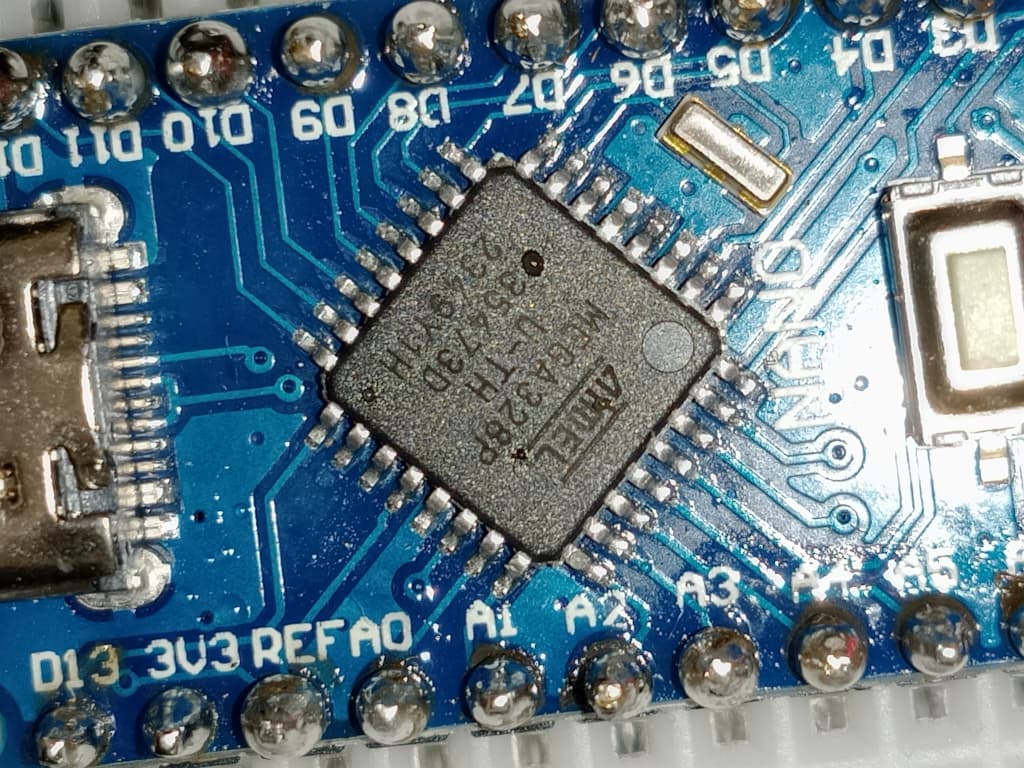

I bought a couple of Nano clones a while back and they work, but with the old bootloader. I decided to attempt to update them a week ago, and have not had any success so far.

that chip may be atmega168
Are you sure about this? The text is physically printed on the chip (Not some dodgy Dymo label). When I select Arduino Nano > ATMega168 and burn bootloader I get the following response:

real name of chip "Atmel ATmega328P-AU" not "U-TH"
Thanks, I overlooked that. Looks like there's something different with these Thai knockoff versions. I'll probably dig deeper a little later down the track, but because it's compiling and running code without issue for now, I'm going to move onto my other projects.
Does it makes any difference for compiling and uploading? As far I know, these versions are fully compatible one with other.
