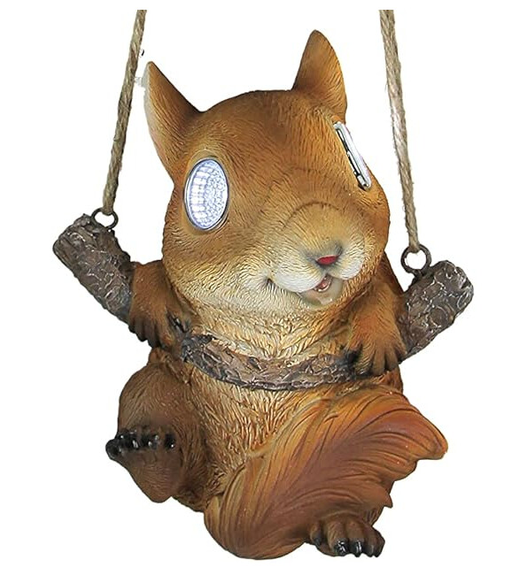

In the absense of further details from the OP, it could be something like this creation which is on sale at Amazon: Amazon.com : Resin Hanging Squirrel Garden Statue Solar LED Eye Lights Animal Yard Decoration : Tools & Home Improvement

Well, it was my late, handicapped brother-in-law's, who died of COVID. My wife repainted it and had me fix the electronics, so the trash is NOT an option.
Garden ornaments like that use the solar panel itself as day/night detector.
They don't have an LDR at all.
The solar panels of those cheap Chinese garden ornaments rot away in less than two years. when kept outside. There is nothing you can do about bad quality.
Buy a bunch of new ones with the same solar cell, and replace when it fails.
By that time you should also replace the rechargeable battery.
Use a hair drier to soften the hot glue around the solar panel.
