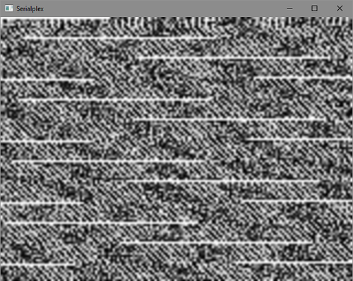

Getting something that loosely resembles the picture:

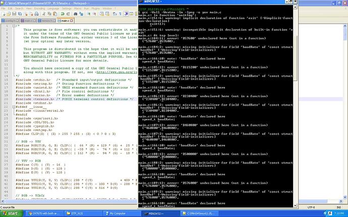

I decided to whip up a quick Script in Cygwin to convert one of the files:
cat /tmp/data06.txt
sed s/" "/\n" "/g |
awk '
BEGIN{CNT=0;print("");} ;
/* Y0 U Y1 V : */
CNT ++;
if(CNT==1) { Y0=strtonum( "0x"$1 ); /print("1: "Y0);/ }
if(CNT==2) { U=strtonum( "0x"$1 ); /print("2: "U);/ }
if(CNT==3) { Y1=strtonum( "0x"$1 ); /print("3: "Y1);/ }
if(CNT==4) {
CNT=0;
V=strtonum( "0x" $1 );
R0 = Y0 + 1.4075 * (V - 128);
if(R0 < 0) R0=0;
if(R0 > 255) R0=255;
G0 = Y0 - (0.3455 * (U - 128)) - (0.7169 * (V - 128));
if(G0 < 0) G0=0;
if(G0 > 255) G0=255;
B0 = Y0 + (1.7790 * (U - 128));
if(B0 < 0) B0=0;
if(B0 > 255) B0=255;
R1 = Y1 + 1.4075 * (V - 128);
if(R1 < 0) R1=0;
if(R1 > 255) R1=255;
G1 = Y1 - (0.3455 * (U - 128)) - (0.7169 * (V - 128));
if(G1 < 0) G1=0;
if(G1 > 255) G1=255;
B1 = Y1 + (1.7790 * (U - 128));
if(B1 < 0) B1=0;
if(B1 > 255) B1=255;
/printf("4: %x %x %x %x \n",Y0,U,Y1,V );/
/printf("%02X %02X %02X %02X %02X %02X %02X %02X \n", R0,G0,B0,00, R1,G1,B1,00);/
printf("%02X %02X %02X %02X %02X %02X \n", B0,G0,R0, B1,G1,R1);
/print strtonum( $1 )/
data06bmp.txt
Attached:
data06.txt - 1 Snapshot (I used text "CAMERA *" to mark Image start/end) in Hex as Yuv422 format
data06bmp.txt - converted to BGR format
_Ard_ov7670_cam_20160918_1M_240x320_24b_006_PIEC_06-04.bmp.txt - is dropped into BMP 24bit file (3 bytes per pixel)
..JPG - to view here.

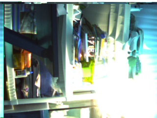

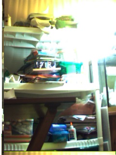

Okay,
New Snapshot, focused out 1 or 2 Lens rotations:
First, looks wierd, but I used 240x320 - backwards.
Second, is Sideways - I guess the Bus is Verticle - not Horiz:
Third, Snapshot aligned- of the children's craft shelf:
Fourth, RGB (not BGR as BMP 24bit specifies on internet):
Success !

Some hints in the Image Downloading and Conversion:
After converting Data from Yuv422 (4bytes per 2pixels) to RGB (6bytes as 2 pixels) ,
  • its easiest to copy this Data into an Empty BitMap File 24bit mode 320x240 at address 0x36.
  • If Image is garbage with Horizontal Segments
    => then Image maybe be saved Wrong as 240x320 - should be 320x240
  • If Image is All PINK
    => Yuv422 data is missaligned/missing (1 or 3) bytes
  • If Image is All CYANA
    => Yuv422 data is missaligned/missing (2) bytes
