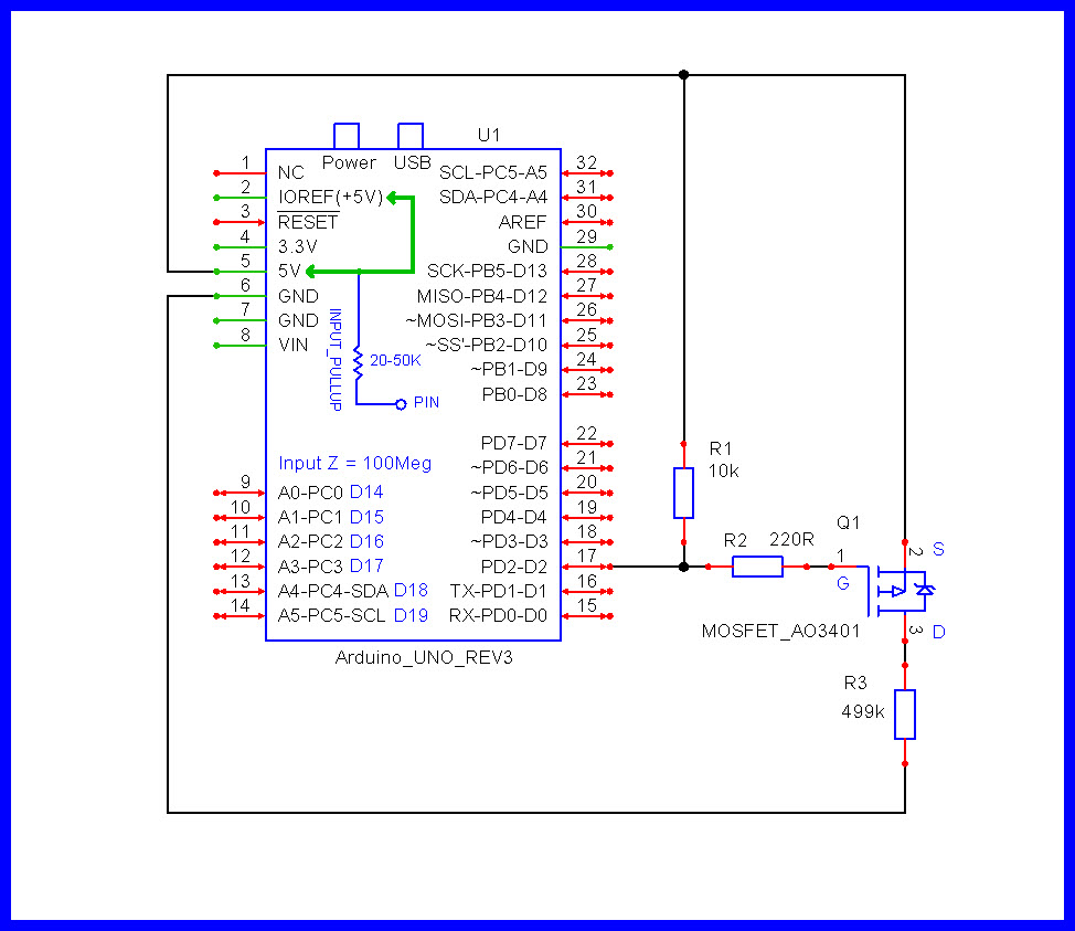

Ran some tests with resistive load i.e. 499K and 5V supply, P channel MOSFET A03401.
All looks as it should.
As before, lets see your wiring :wink:
Across the 499k load.
Yes, you're pulling-up the Gate, larryd.
(No previous mention of that.)
the output does not go up to 5V and stay there as I had expected, instead it seems to be fluctuating between 2-5V really fast or something like that. I tried connecting a 10Kohm resistor in parallel to my load but that did not solve the problem.
Disconnect the arduino, put the 10k from the gate to ground. If the device is functioning the drain should be 5V.
Lot's of good info. I will run my experiments and report back tomorrow. But I think the last comment hit the nail on the head. I am currently not pulling up the gate as I see the problem happen when the gate goes to 0V (turns on). But perhaps that will make a difference after all. I should have tried it as I usually add pull-up/down resistors but here I did not think about it. It is worth trying at least. Good points. Thanks again!
R1 discharges gate; makes no difference for my test as the Arduino goes 5v to 0v.
If the OP is not using a similar driving cct. then the gate may never be discharging, i.e. MOSFET never turns off.

Thanks for all your inputs! I have done some experiments and I think the main issue was bad contact in my breadboard... as the problem seemed intermittent. However, I did experiment with both MOSFETs and bipolar transistors and just to make sure the issue was not related to my FETs I changed my design to use a bipolar transistors instead (I had an N-channel and a P-channel MOSFET before). It is not a low-power design so it works great (I am using a 2N2222 NPN instead of the N-channel MOSFET and a 2N2907 instead of the P-channel MOSFET). By using the bipolar transistors with 500 ohm base resistors it all seems to work great.
Lessons learned here: Switching a high-impedance load is not harder than a regular load (that was my main concern). Bread-boards might give head-ache at times, and using NPN/PNP transistors is a better choice in this case as I am not aiming for low power consumption or switching high currents. Thank you all!
