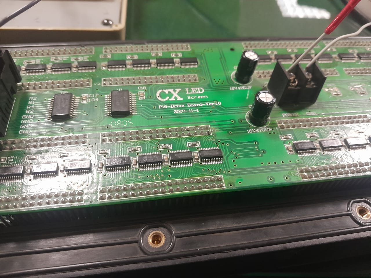

I am using some P16 Drive Board Version 4.0 RGB LED MATRIX PANNEL Module for custom Display of Text... I donot know how to display custom text ,, i watch tutorial on youtube they have P10 led module and there is Library name RGB matrix pannel but this library and the pins in the library is not matching with mine one ,, i dont know which library i will use for it... ANY one Wantns to Help

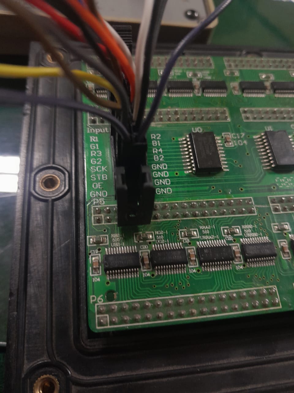

Ignore the connection of Pins at Input which i done....Just check the Pins they have 16 pins 5 pins are GND , R1 ,R2 , G1 , B1 , R3 , R4 , G2 , B2 , SCK , STB , OE i have no idea how to connect them with Arduino and display custom Text...Which library i will use in Arduino Ide earlier i try RGB Matrix Pannel Library but it was for the P10 Led moudle ... not for this one as well as Pins were also change from each other....Simple i want to display text how can I

74Hc2450
the picture above isnt clear enough. i cant see the part no. on IC
sorry, but we don't share personal contacts here.
there are two types of ICs. Post a clear picture so the part number is clearly visible
or more
Most RGB panels has a three type of IC - led driver, line driver and a buffer.
The specified 74HC245 chip is a buffer, the least important of all :slight_smile:
Perhaps the pins R3 and R4 corresponds to A & B on P10 RGB panels.
With this assumption, all pins fully comply with the HUB75 standard of modern RGB matrices, so you could try to run the panel with RGBMatrixPanel library.
But P10 have C D pins along with A B so the RGB matrix pannel library have code for the A b c d pins so what can i do next , should i remove the C d from code or from the matrix library ?
Here in pic i write the pins then as you mention Hub75 pins configuration then let me know about this pins what it called as you mention Hub75 then it will be Hub76? Or some.other name ? And also let me know the libray arduino library for.this config as in pic arduino have RGB matrix pannel library for Hub75 config P10 !! but i donot know they have library for the Pic o have attached p16 ? Let me know.or give me clue how can i connect this with arduino for text display
P10 and P16 (and also P3, P6 and so on) - not more than a pitch between pixels in mm. "P10" say nothing about the matrix type and its protocol.
I have been working with LED matrices for 7 years and have seen a lot of different matrices.
Your panel looks quite old and non-standard. Most likely you will not find a library designed specifically for such a panel. If you want to run it, then you have no choice but to experiment with different libraries and pin connections. I offered you a connection option, but I do not guarantee that it will work. This can only be established by experience.

I found the pinout of your panel in the internet. Such type is called as "HUB40" .
