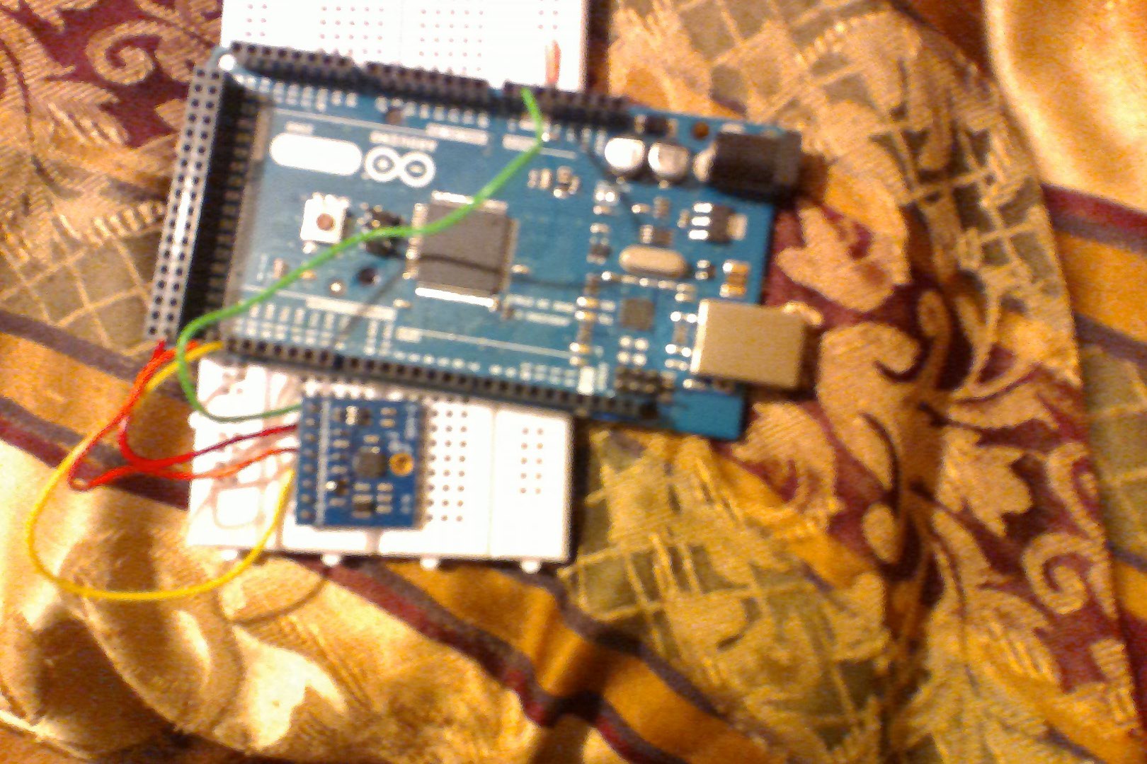

i have the gyroscope scope sensor, although i had it working in the past i had to trade my laptop and cant find my backed up hardrive to retrieve files.
does anyone know where i can find the library files for this. i've downloaded several codes from different sources but i get nothing on the serial.
i have a Arduino Mega 2560 hoocked up to the GND, 5V, SCL, and SDA pins to the Parallax L3G4200D.

Cool, that module has indeed everything as madmattd wrote, a voltage regulator and level shifting. You can connect it to a 5V Arduino.
So you connected it right. With the Mega pins 5V, GND, SCL and SDA.
The i2c scanner should be able to detect it, or else something is wrong.
Did you use the SCL and SDA pins ? Or accidently the A4 and A5 (A4 and A5 are I2C on the Arduino Uno, but not on the Arduino Mega).

Perhaps you bought a faulty sensor module. The L3G4200D is protected by the level shifter and voltage regulator. I can't believe it is doing nothing.
You could make a photo of the wiring, so we can check it.
When the i2c scanner can't see it, there is no use to try a library. If the i2c scanner can't see it, the sensor is not available on the I2C bus.

Here is how i hooked it up :smiley: , sorry for the bad quality surface pro 3 doesn't have very good camara.
