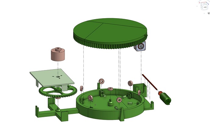

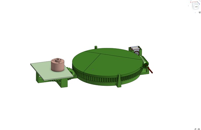

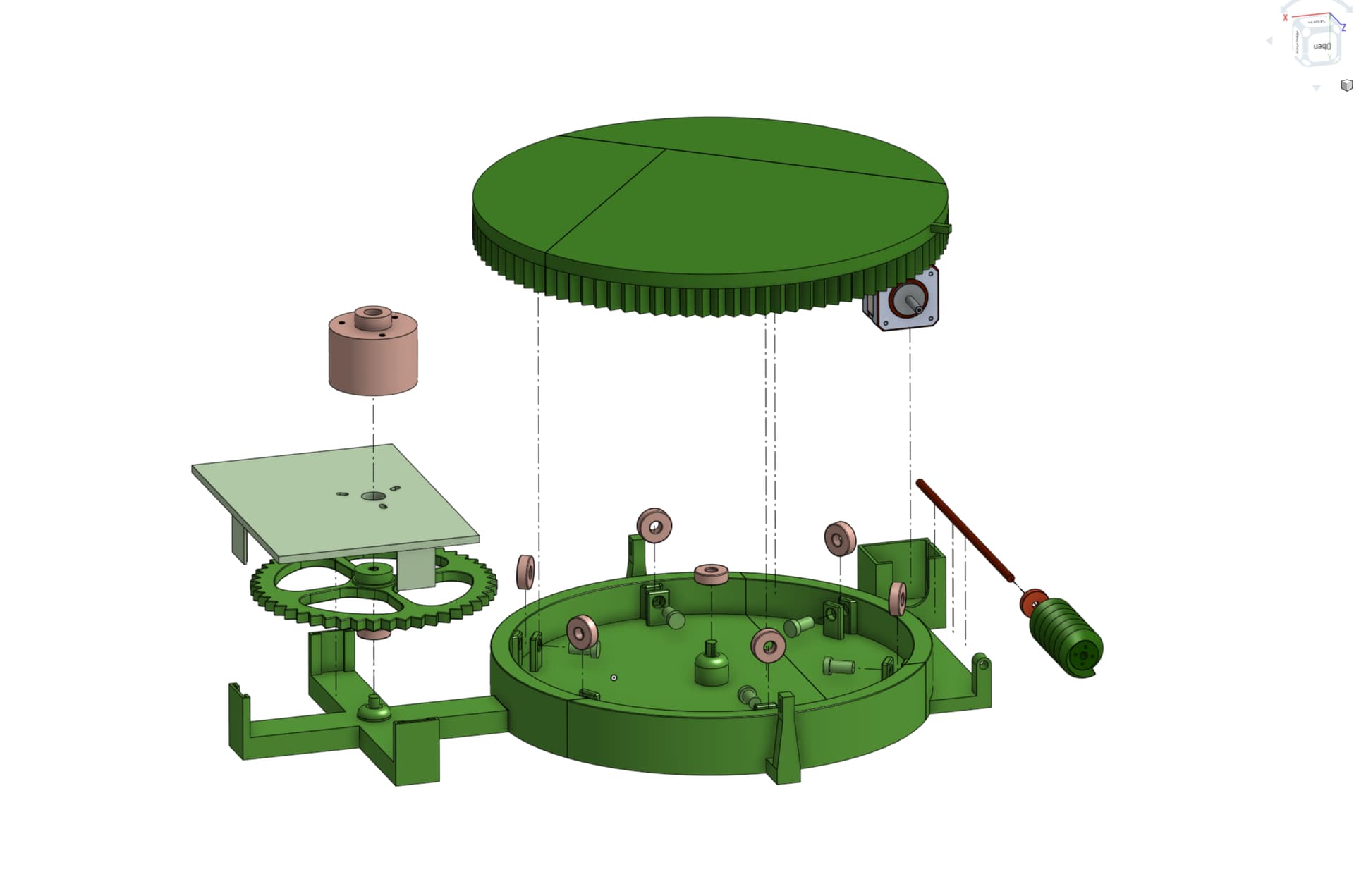

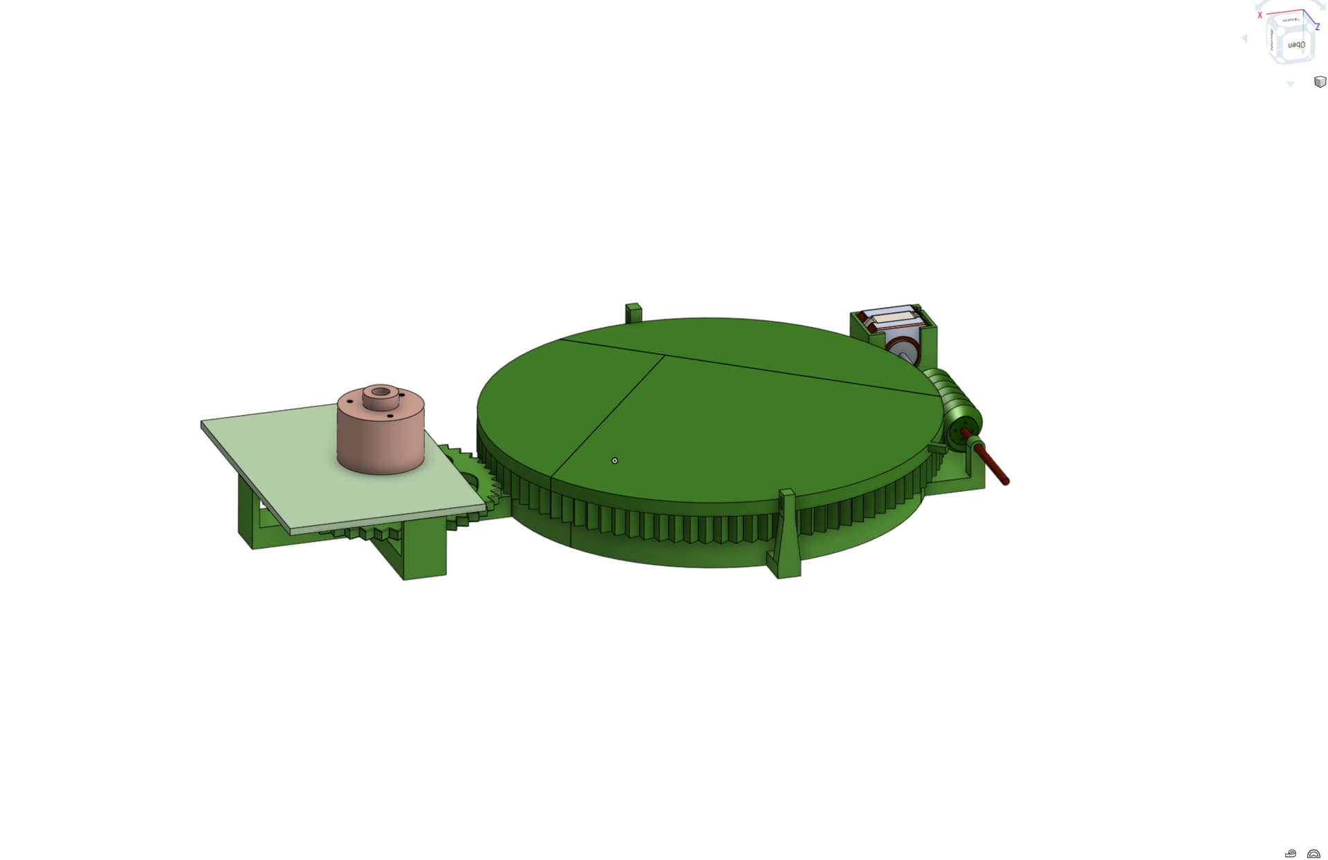

I have a rotating platform equipped with a stepper motor connected to a worm gear mechanism. To restrict rotation, I plan to incorporate an incremental rotary encoder from Baumer Electric. Datasheet of rotary encoder: https://www.baumer.com/medias/__secure__/Baumer_BRIH40_EcoMag_DS_EN.pdf?mediaPK=8800786513950

In my 3D-printed base, where the platform rotates, I've also incorporated cutouts for two limit switches. If I have additional time, I'm considering implementing these switches as an added safety feature.
Hardware:
Explosion Photo: if it enhances comprehension:
