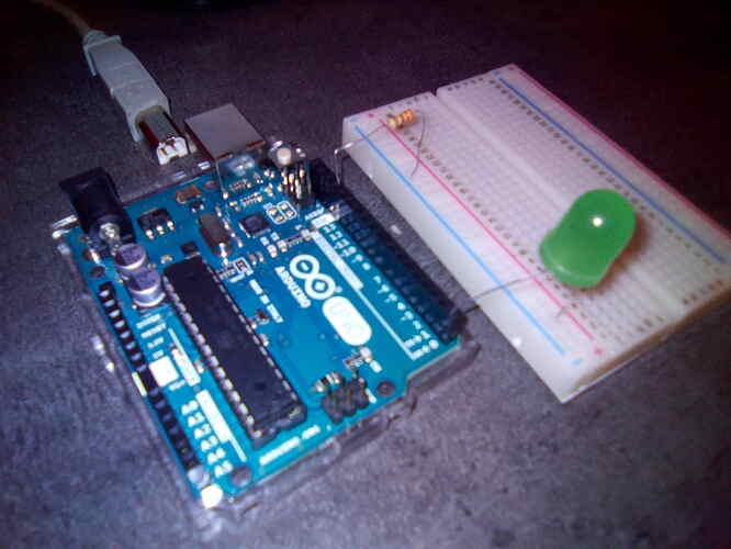

I am quite new on Arduino.
I have done a circuit for a blinking LED (with a 330Ohm resistor) with an arduino Uno on digital Pin 0 and it works perfectly (see first image).
Now I would like to have the same with the ATMega on a breadboard.
I am using the ATMega of the Uno so I am sure that the program is on it and running. I have removed the ATMega from the Uno and clip it on the breadboard. I am using the 5V of the uno board to power the ATMega (pin 7 VCC and 8 ground ) and I have attached the LED and the resistor in serie between the pin 2 of the ATMega (corresponding to the digital pin 0 of the uno) and the ground (see second attached image). But the LED is not blinking...When I attach the LED to the pin 7 or pin 20 the LED is bright.
I am probably doing something stupid...What should I do to get my LED blinking ?
The Uno has a 16 MHz external clock source, so the fuses of the ATmega328P on the Uno are set for this. Your breadboard circuit does not have a clock source so the microcontroller doesn't run. It is possible to use the internal oscillator on the ATmega328P for the clock but this requires setting the fuses accordingly using an ISP programmer.
You should also have decoupling capacitors on the power lines as close to the microcontroller as possible.
I recommend closely reading this excellent tutorial:

I finally succeed in blinking my LED on the breadboard !
I followed the tutorial pointed by pert
I didn't use the pull-up resistor nor the decoupling capacitor mentioned.
I have connect a second chip (that I hopefully had) as mentioned but failed to "detect the board". I had to wire the clock on the D9 pin (explained in the part Alternate clock source).
The I burned the Lilypad (8 MHz) loader.
And then I change to this tutorial:
I did the wiring explained for "Uploading Using an Arduino Board" and used the "ATmega328 on a breadboard (8 MHz internal clock)" setting and the LED is blinking !
