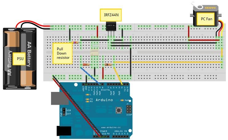

is the optocoupler isolated of amperage as drawn at the diagram? Can pin 6 be connected to the arduino 9v?

Can anybody confirm if the ampere is isolated to the optocoupler with this diagram? Because the + of psu is connected to pin 6 of optocoupler.

This pic is better.

I think I see several wiring errors, but I refuse to try and make sense of such pictorial pictures, when what is really required is a proper schematic drawing. However hang on for others that might have a higher threshold of pain the I do.

That circuit is not right. There is a common ground on both sides of the circuit, this means it is not isolated. As lefty says it is very difficult to follow a physical layout and generate a schematic from that. In fact is is impossible for anything but the most trivial circuit. You must have a schematic because you made it (you can't pretend to make anything without a schematic) so could you post that. Even a photo of a hand drawn one would be fine. It is much easier generating a physical layout from the schematic. But you don't look like you have got it quite right yet. Also is the FET part number correct?
I'm just started learning electro. I will post a schematic tonight. The fet name is right I think, I have to double check maybe. So if I understand, common must be seperated. But the + also goes to the optocoupler, I think thats also not right.
The opto coupler has two sides, it is quite alright for the + and ground to go the opto providing that only fan and fet connections go to the output side and only arduino and arduino ground go to the input side.
