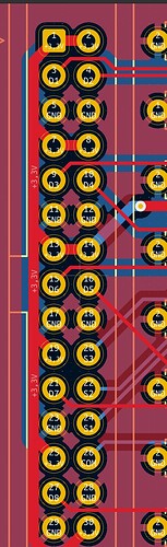

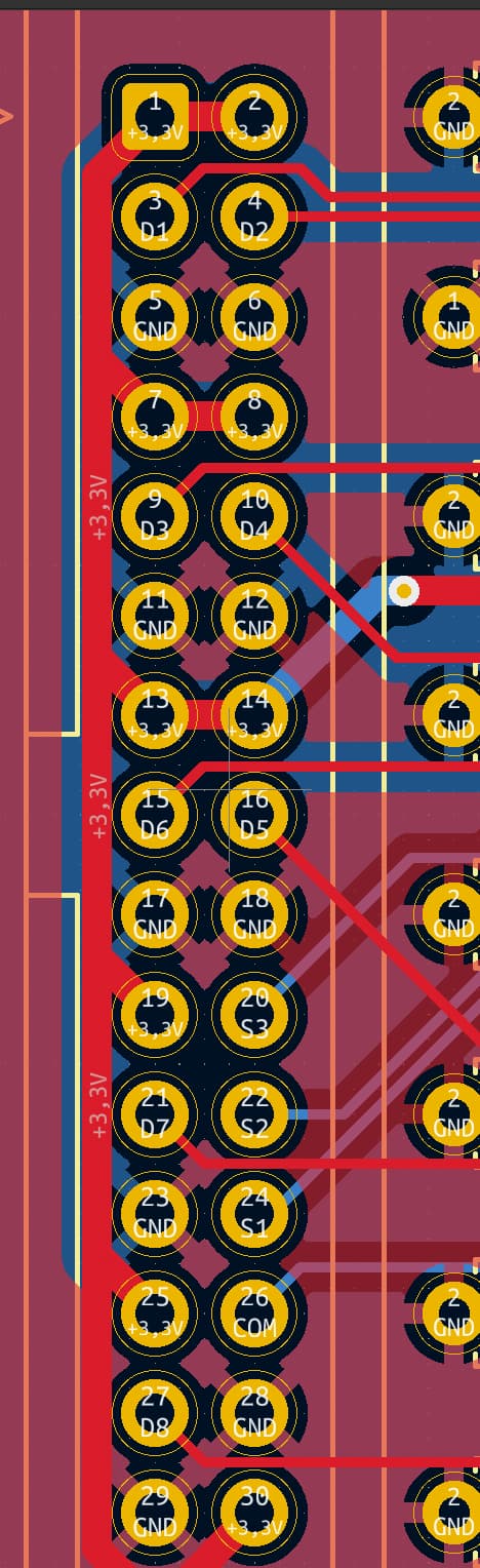

I just redesigned the PCB using your advices. I still sticked to the 30pin connector but kept the potentiometer wire groups together. What do you think?

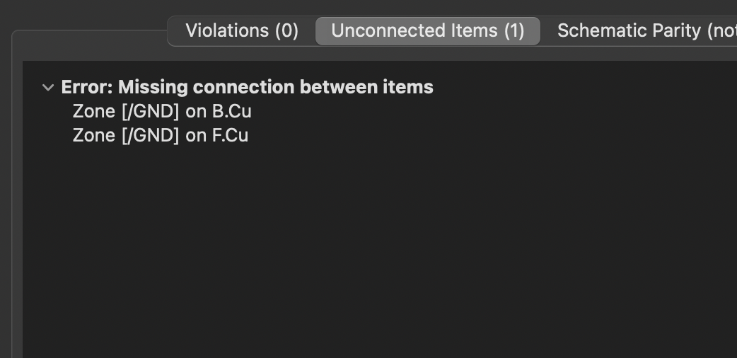

I just figured out that this error occours because I created a power plane island somewhere but i just can't find it. I would appreciate every hint. :smiley: Thank you!
The Kicad design rules check normally leaves tiny yellow arrows where there is a problem.
Also clicking on the error message tends to bring the problem area into focus.
The suggestion I made in reply #24 doesn't work because it doesn't take account of the order the wires connect to the connector. Sorry for the mistake but you will need to design the board again.

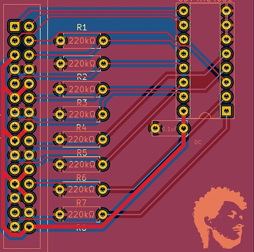

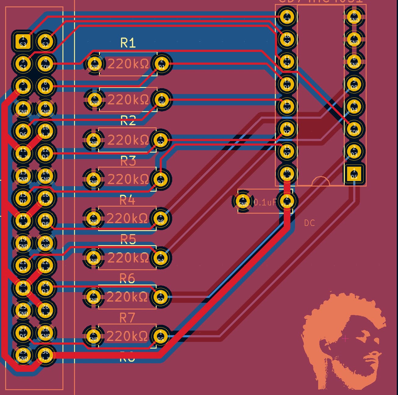

I just redesigned it the way you suggested and it looks the best to me and also it doesn't have any design rule error/warning.
What do you think about it?

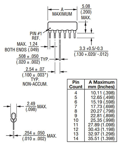

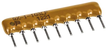

Do yourself a huge favour and use a SIP resistor network.

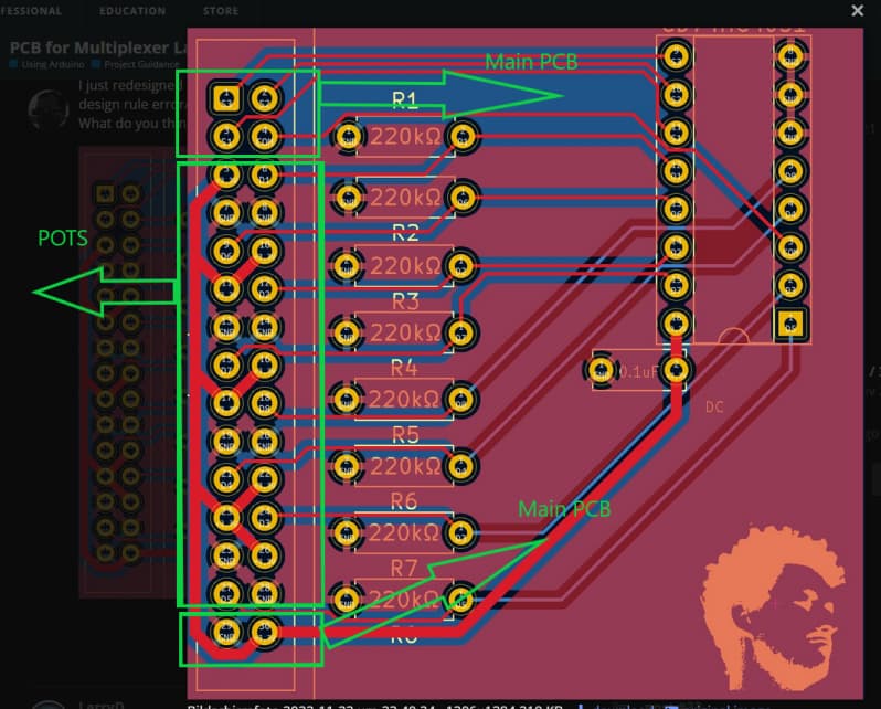

Your wiring layout could probably be better consolidated to avoid cable groups going to different destinations :
You could also add a couple of vias in the bare area on the front copper layer around the R1 label.
What about mounting holes or is that just the way you have cropped the image ?

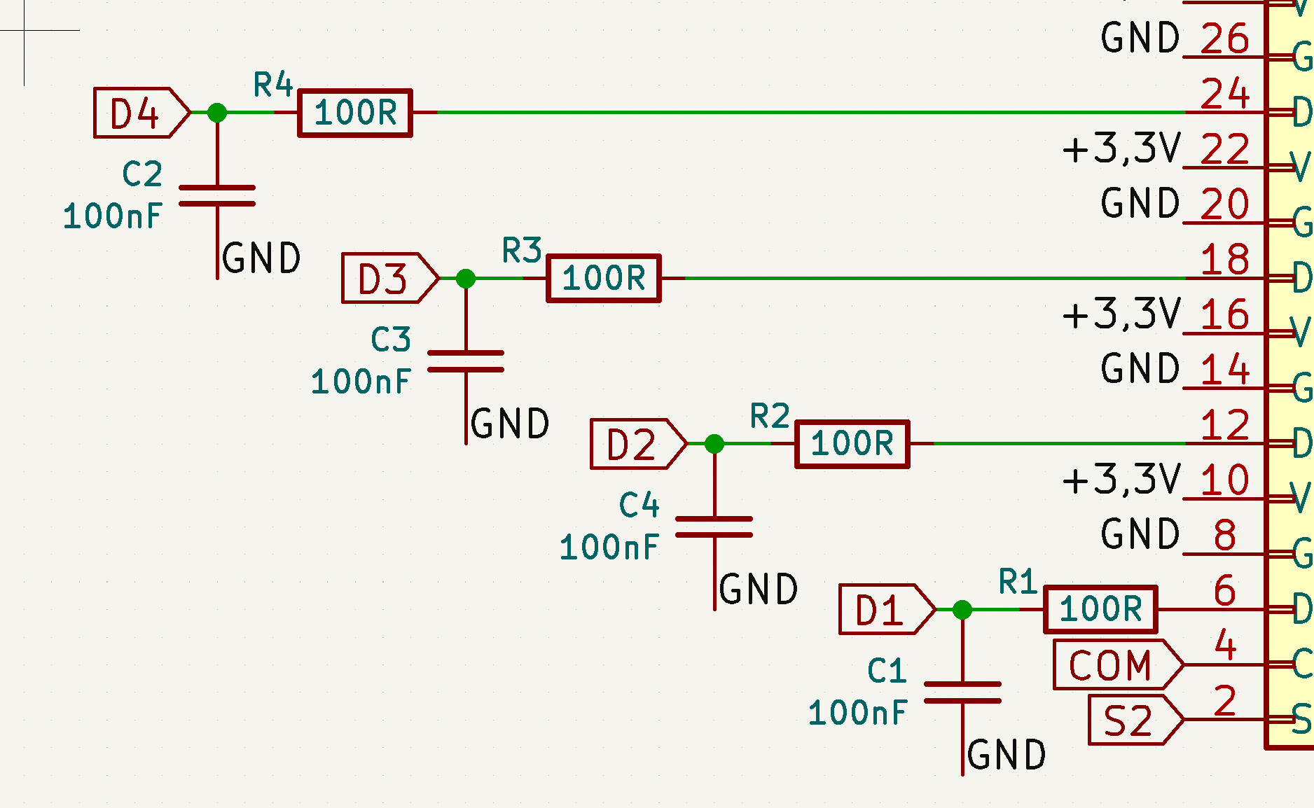

I thought about using capacitors like in one of the first pictures I've attached, because the frequency of the value change of the potentiometer is going to be pretty low. (it's going to be tweaked with my hands, so nothing really fast)
By using a pull down resistor, all I'd get is the value dropping down to 0 whenever there is a small moment of floating inside the potentiometer or not? By using the capacitor I'd basically have a "sample and hold" method to save values for a short period of time to avoid any random jumps. What do you think?

Following on from @6v6gt's suggestion on reply 34 I would use 2 connectors, one for the link to the main PCB and one for the pots. Also consider how multiple boards will be connected to each other.

My idea behind only one connector was that it's less complicated and for the serial wires, I planned to use a long ribbon cable, which I can cascade by clipping headers on it wherever I have a Multiplexer PCB.
Also I thought that it's always better to have every incoming cable in one place instead of splitting it to two or three different ones.
For the communication pin and power and ground cable I could also simply stick to the 30 pin connector and just split the ribbon cable partially.
Another reason was simply the fact, that I couldn't find all the different components in Germany with similiar specs like same pitch for example.
I mean, at the end of the day, it doesn't count, but I'd still love to use 2.54mm for every connector so that I don't have to keep that in my mind.
If you both suggest me though, that it's a better idea to split it, I'd switch to that and re-design the PCB.
Then, I'd even take three instead of two connectors:
24pins for the pots
6 serial (3in, 3out in order to cascade it) - used between the multiplexer PCBs
3 to the main board - 1 ground, 1 power, 1 multiplexer communication pin
What do you think about this? :slight_smile:
Have you looked at using a SIP resistor network ?
Yes I did, but I thought it's only relevant if I'd do it the way how GrumpyMike suggested it, by not using capacitors. This way, it makes sense to me to use the SIP resistor network, but I thought that you can't connect it if you have it between data pin and the connector. (see attached picture) This way, every resistor would need two individual legs and not one which is always connected to a common ground.
It's a really good idea though, if I'd stick to the version without the capacitors and using an SIP resistor network only as pulldowns.
Or did I misunderstand it? Please correct me if I'm wrong.
