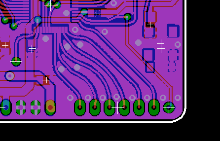

The PCB I am working on is only 2-sided proto-board. I took everyones advice and put the ground plane on the backside of PCB. I have never soldered a PCB with vias in contacts before. I have heard of doing that in the past but, I didn't take it seriously until now. I put a power plane on the front side as well. Bonus, I was able to reduce the design by a couple of millimeters by doing the contact vias. :+1:
I will post the project once I debug the PCBs.

Be careful with vias in pads. I generally either have a very short trace or a pour on pads that extend past the pad and put the vias there. Vias in pads can lead to tombstoning components, the solder likes to pull through the via to the ground plane and not leave enough for a good connection on the pad.
Mind you, it can be done, just be careful.
I did it both ways because some of my contacts were too small for vias.

Then your layout may be bad. If you can't connect two points with a trace, then a copper pour will also not work.
Using copper pours for power can be misleading since it may contain long and/or very narrow copper paths that can't handle the current
I did add a trace with a lot of vias to connect the smaller islands. Just to get the whole ground plane grounded.
It doesn't impact the price of the proto-board. But, It looks like a lot of extra stuff.
Via Snake
and probably useless and unnecessary.
A ground or power plane is one layer of solid unbroken copper.
What you are doing is just connecting nets using a copper pour.
If you can't lay out a single-sided board, you probably can't lay out a board with a "ground plane of solid unbroken copper."
And your whole board doesn't need a ground plane - if you can get relatively unbroken copper under your high frequency areas that are more susceptible to noise, you'll be doing better than most...
because I couldn't find a route for a trace.
That's a bad sign, though. If you couldn't route a ground trace, it probably means that your ground pour is following a really convoluted path...

The islands are being created by two connectors sharing circuits.
My original question was how to deal with the dead islands:
A: Connected islands with complete ground plane (first image).
B: Deleted islands (2nd image black area).
C: Dead islands (3rd image non glowing gray area).
BTW, those are three different configurations of the rear ground plane.
You guys are leaning towards the "B" answer... deleted dead islands.
I did this "ground-planed and sort-of shielded" area for the analog area of an Arduino-like board. It seemed like a reasonable idea. I haven't done any testing that would show it better or worse than other solutions, EMI or noise -wise.
So, those are vias connecting each other? With a trace or a plane connecting each other?
I did a simular version in my image A (2 posts ago).

Yeah; ground fill/"trace", connect with vias to the ground plane on the other side of the board...
