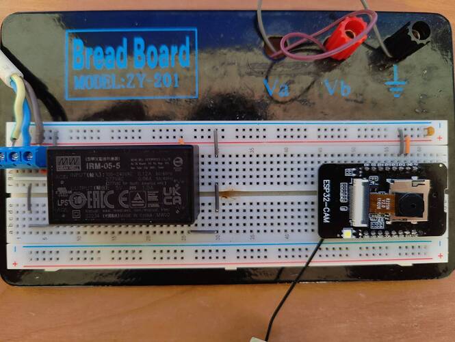

as title says, I'm looking for reliable power source for Esp32Cam.
I was using this one for powering MKR1000, but no luck with Esp32Cam.
I have tried to add 104pF ceramic capacitor on the power rails, but didn't help.
Is there some obvious reason why this power source shouldn't work that I don't see? Is there something more I can try to "smooth" the output of this one to make ESP32 like it?
Thanks

Can you elaborate on "no luck". You've linked to a 5V/2A medical grade supply that really doesn't need output filtering. I run an ESP32-CAM with the USB adapter board and power the lot with a 1A USB supply with no issues.
5V 10W, that's correct. it just wont start. the ESP32. I can measure 5V on the output. I have tried two ESPs: one with built in serial to usb and one without. One of them started for one time, I issued command via mqtt to take the photo at that moment it stopped working and didn't blinked since. Maybe I have a bad piece or something, ESPs are working on usb fine..
Show a schematic of your project and a clear photograph of how you have everything wired up.
For a 3.3v device a 3.3v PSU seems more appropriate unless there are also 5v components to be powered. 2A seems like overkill though. But as stated before it should just work.

alright, solved now and it was power issue at the end.
what worked is putting the little ceramic capacitor closer to the ESP32 pins. before, I had it on the end of power rails, also it needs to have that 2A power source, on the 1A which I photographed it still wont work, but with 10W 5V it is enough.
WiFi communication involves peak currents in the range of a few hundred mA. Apparently your power supply destabilized under these conditions, forcing the ESP in a brownout condition or a reset loop. Generally a 5W power supply is more than adequate with decent circuit design, unless there are other power-hungry components part of the system.
well to improve my circuit design was basically initial intention of this post, you see
