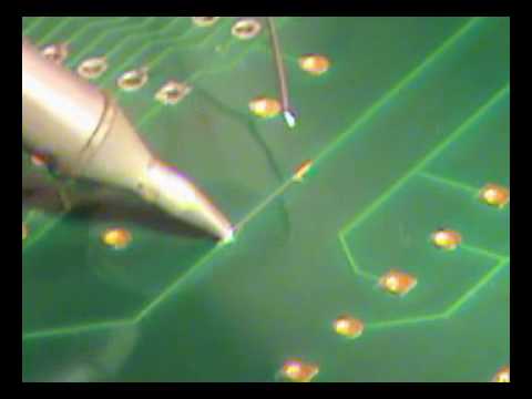

PS: I appreciate this demo on repairing burned traces:
Any thoughts?
