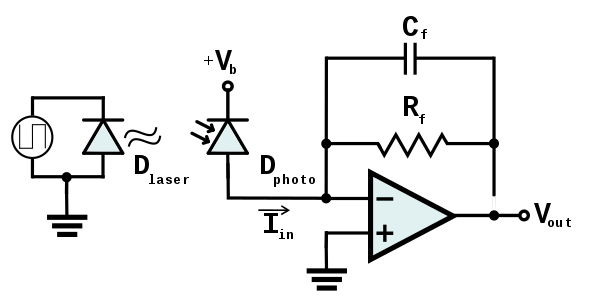

Photodiodes provide low current only, what makes loading the input capacitor slow. Add a quick amplifier that can provide more current.

It can be interesting! For example a diode capacitance decreases with reverse bias, so a reverse bias increases bandwidth. See the bias connection "+Vb" below. :slight_smile: Edit, OOps it's been edited, oh well..
Search for "photodiode transimpedance amplifier". One simple example below.
From Optimizing Precision Photodiode Sensor Circuit Design | Analog Devices
Here is the image that @anon57585045 referred to. It is an alternative circuit with reverse bias, which speeds up the response. I replaced it because of the broken connection on the right.

The circuits that maximize sensitivity, decrease bandwidth, and vice versa. If your circuit requires an op amp, make sure it's a fast one. No LM741 here please. :slight_smile: A JFET input op amp would be a good choice to minimize input DC offset.

The first circuit provides a positive Vout that can be connected to an Arduino input, but it is incomplete. You need a fast op amp and a few additional components. The second circuit cannot be directly connected to Arduino, as the output is a negative voltage.
