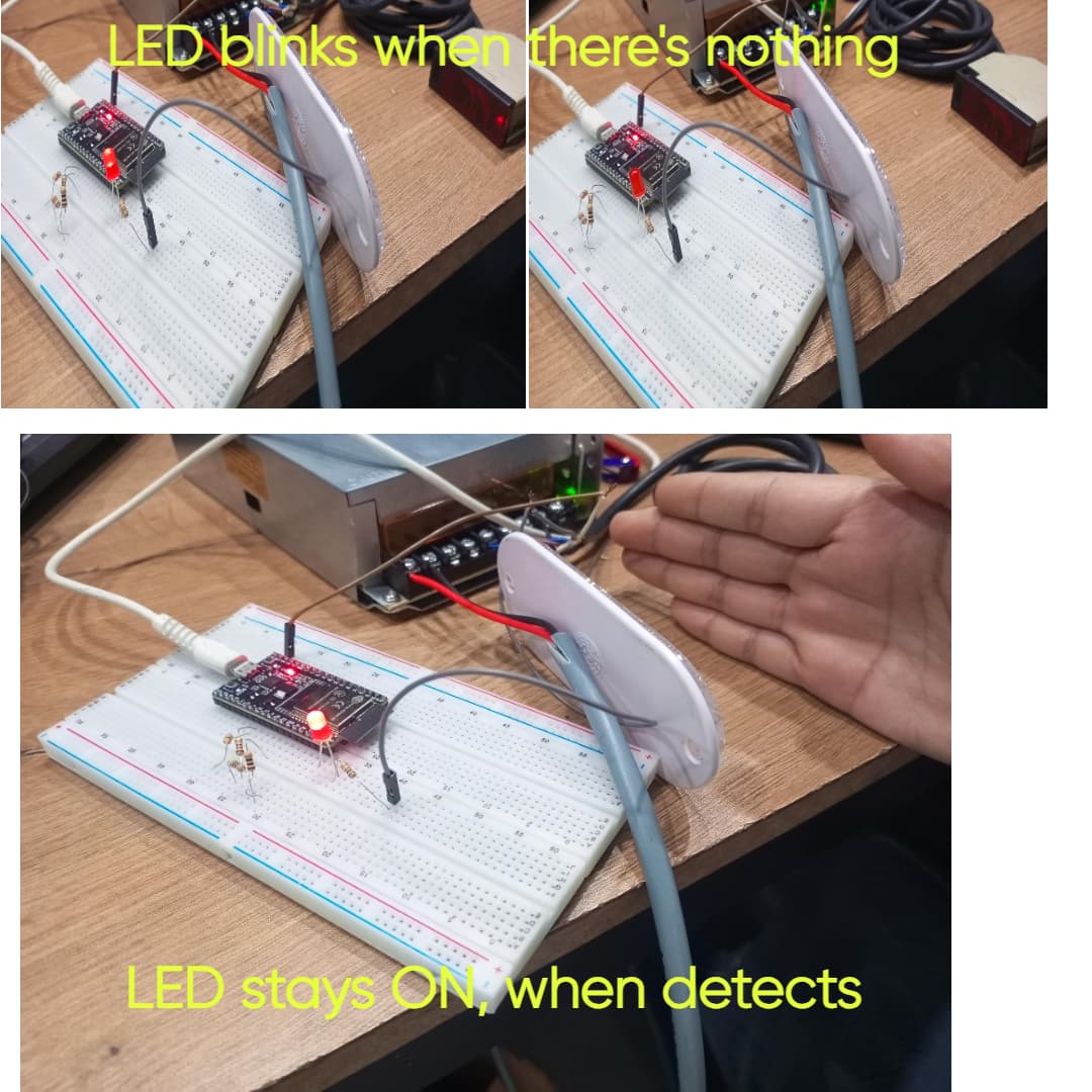

Photoelectric sensor E3JK-R4M1 with ESP 32 Wroom 32D
@jim-p there's no any adjustment point on sensor body, how I'll do that?
@jim-p I want sensor to detect object and send signal to LCD to count it. and when there's no object, sensor should not detect and LCD should not count.
But in my scenario, the red indicator beeps when no object and LCD counts, and as soon as object comes, red indicator disappears and LCD stops counting.
@jim-p what should I do now?

You've understood that a led needs a current limiting resistor (say 300R to 1k ) if you are powering it with 5 volts DC .
What, incidentally, is the source of the 5v DC that you have been applying to the sensor? I'm beginning to suspect that a plausible explanation for the symptoms you have described (continuous counting when the relay is in a specific state) is a failure to understand that the GND connection in the diagram in post #4 must (also) be connected to the GND of the ESP32.

That is, I'd guess that since the counter code looks OK (although the results may be inverted) and the module relay could not cause the unwanted "counts", at least not at the frequency you have reported, then the cause is probably a floating ESP32 pin. This may not have been visible in the sketch in post #22 because of the 200ms delay. Also, since you appear to have made a voltage divider by chaining a number of resistors in series, a break somewhere in that chain could also lead to floating ESP32 pin.
Are you using the gray or black wire?
Show a diagram of how you have things connected.
@6v6gt I have tested it.
When hand/object comes infront of sensor, LED stays ON, and when there's nothing, sensor and LED both blink with frequency of mili seconds and sometimes 1 second delay, both not properly stay OFF.
@6v6gt I'm powering it from the ESP32's 5V pin.

Using grey Wire
Run the sketch from post #22.
What happens?
Dear All,
It is counting now with respect to required condition.
The position of sensor was horizontal, which was creating problem, I placed sensor vertically and now it's OK.
