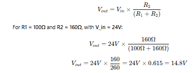

when BRN is connected to +24V, then Vin is 24V. how these mentioned resistors will provide 3.3V with Vin 24V. I didn't understand this. Also white wire will be connected to GND or 5V of ESP 32 wroom 32D. Please explain.
Thankyou for your help.
There is no Vin on my schematic.
Where is this Vin?
Vin in Voltage divider rule:
For ESP 32 Wroom 32D we want 3.3v
The white wire is connected to 5V NOT 24V.
When the relay closes, 5V will be connected to the voltage divider.
May be I'm a lil confused, which relay you are talking about,
that is already built in sensor or we will use separate 5v relay?
The relay that is inside the sensor.
Let me test then I will update you. I hope it will work
No hurry.
please help in understanding the resistors that you mentioned: 100 ohm and 160 ohm, to convert 24V to 3.3V. with Vin =5V, the step down voltage will be 3.08V not 3.3V (to be used on ESP32). should not I use resistors that give exact step down 3.3V.
No, because if the 5V is actually a little higher like maybe 5.15V then the output would be higher than 3.3V and you don't want that.

Hey @jim-p
I don't have 160 ohm resistor. I have 4.7k, 6.8k, 330, 470, 47k, 100k, 47, 220, 2.2k, 1k, 100, 10k, 22k, 10, 220k resistors.
Please guide, which any of two can I use among above mentioned, to get 3.3V or closer.
Anyone else here to help!
100+10+47 = 157, close enough
Connect them in Series.
